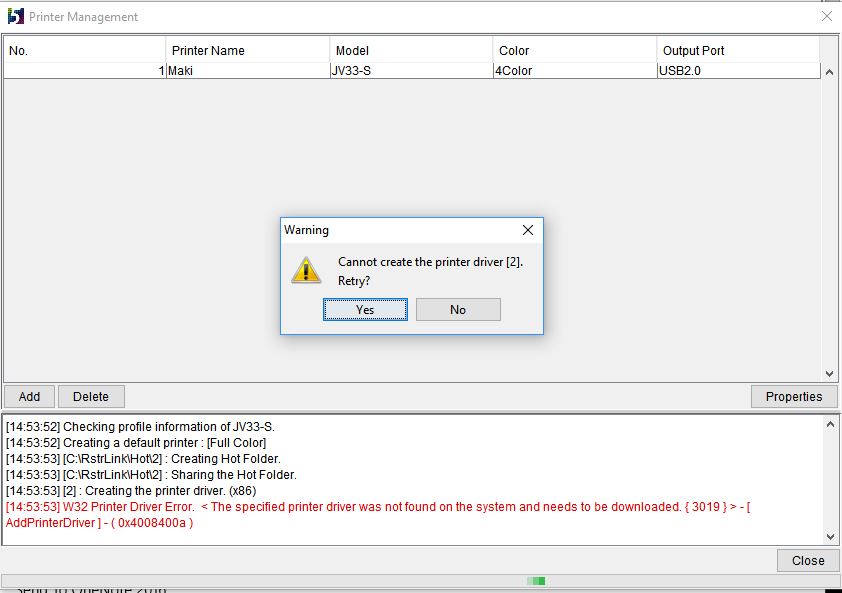

Hi All.
I am currently trying to get a second JC33 working on the same pc so i can control both from rasterlink.
I am currently running windows 10 64bit and have tried to add the second printer under printer management but i get an error and i cannot seem to get around it. I have attached an image so if you know how to get round this please let me know :)

Make sure you have different ports setup not the same

They are are on different ports, issue comes that i cannot manaually add the printer driver for the second Mimaki becuase the drivers come in exe format and not *.inf . I can see the printer in my system and in the list when trying to add it but it just gives the driver error as you see in the image.
