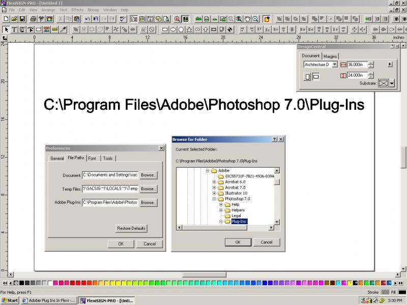

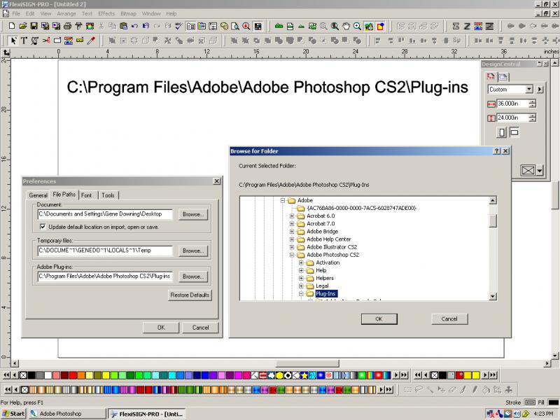

I'm not quite sure which Adobe folder you are refering to, also not sure if this might be a Vista issue or not seems I run Flexi on XP & Win 98 OS systems only. This is how they appear on my XP systems, hope this helps.

Thank you for your replys. I figured out what was wrong...Im running flexi as previously mentioned. Operating system is vista 64 bit. I also run cs 4 which is 64 bit. Although flexi is vista compatable it is still a 32 bit program. When setting the preferences in flexi it was defaulting to the 64 bit plug-ins within adobie. You must point flexi to the 32 bit plug-ins within cs4 for it to work. There are two different files for the plug-ins.
