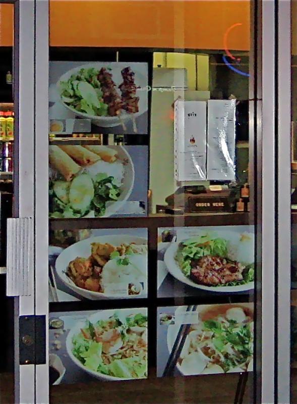

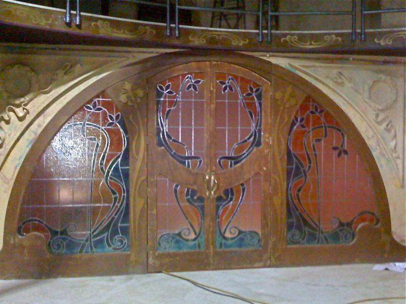

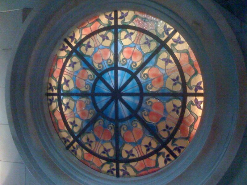

Proof that you can print on clear. Sorry, crappy cell phone pics.
From left to right.
Reverse print on cleat with white backer mounted inside window.
Clear mounted to milk plexi
the last 2 are clear mounted to clear plexi for stained glass look.
This is all printed at double pass.

iSign
cool!!
so, are they all including a white backer?
that first stained glass one is unbelievable... they silvery-gray lines that would be "lead" in real stained glass, seems to be reflecting the light differently... what's going on there, that looks too real... is this really just reverse printing on clear plex, or did you did the lead lines on the front with silver cut vinyl?
Sticky Signs
ISign, Sorry, I should of explained more.
the first one is on white backer. The second is just clear mounted to milk plexi.
The stained glass is what we call "movie magic". They are from the "watch tower" set on Smallville. Clear vinyl mounted to the back side of clear plexi. The lead lines are made with lead tape and the texture is a done using a 2 part resin. The lead and resin are applied to the face of the plexi. Its a real PITA but the end results are worth it.
