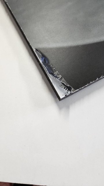

do you print on standard acrylic? We have found we have to print on Plaskolite or Similar DA substrate for acrylic....otherwise it just peels off if we router to the edge of the image or flood white for standoff prints. Dibond chips and flakes.....and had issues even with certain batches of Ultraboard plastic faced. The lamps are still under the max hours by a lot. Currently we're down with a 10 month old part that died.

Just one small sample on UB W/B/B....cast matte lam on top and then trimmed/routered.

AGFA has said "nobody else is having these issues" but when I showed pics....they couldn't give me a reasonable answer. Lamps up to max didnt work.
