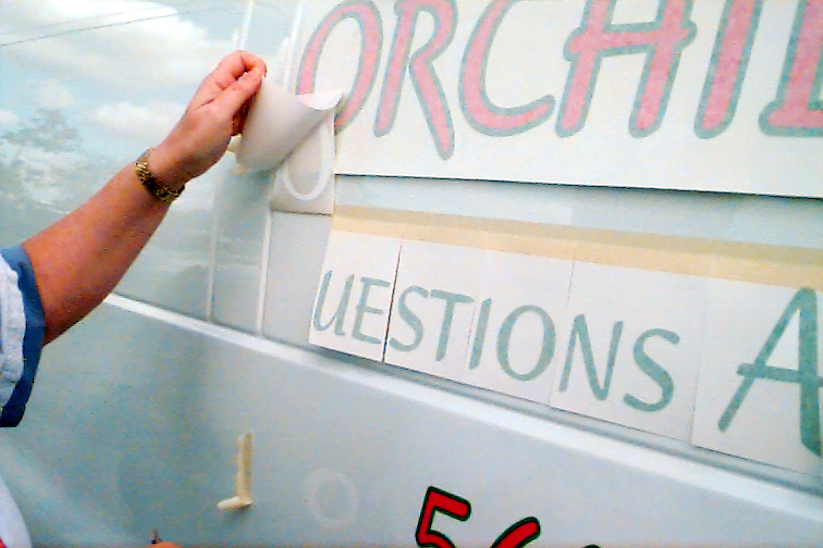

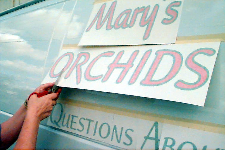

3. Whenever possible, section down your graphic so as to work smaller areas at a time. I personally prefer a horizontal hinge and vertical scissor cuts between letters and objects.

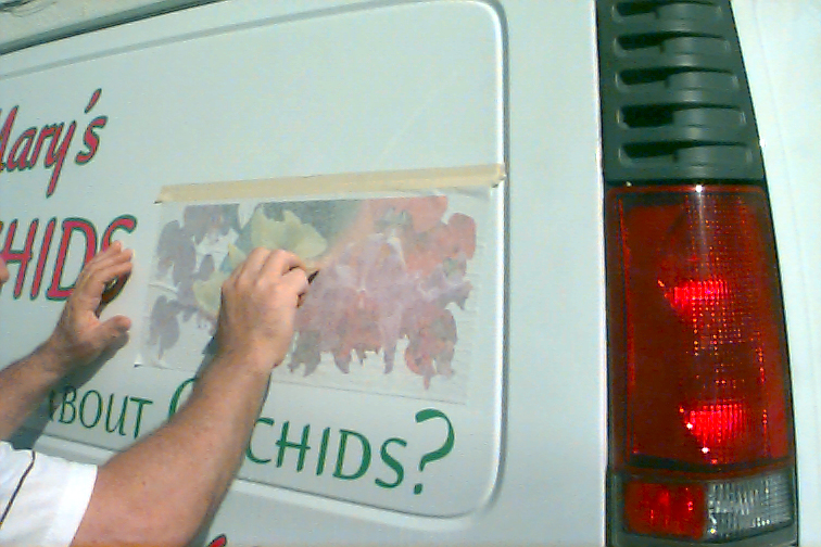

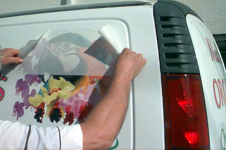

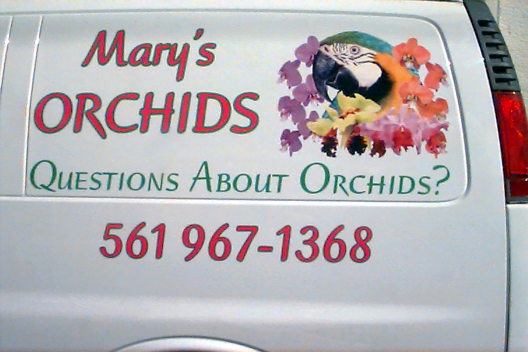

The attached images show dry, sectioned down, horizontal hinge application of the letters and a wet application of the graphic because it was in panels that required perfect alignment to each other.
