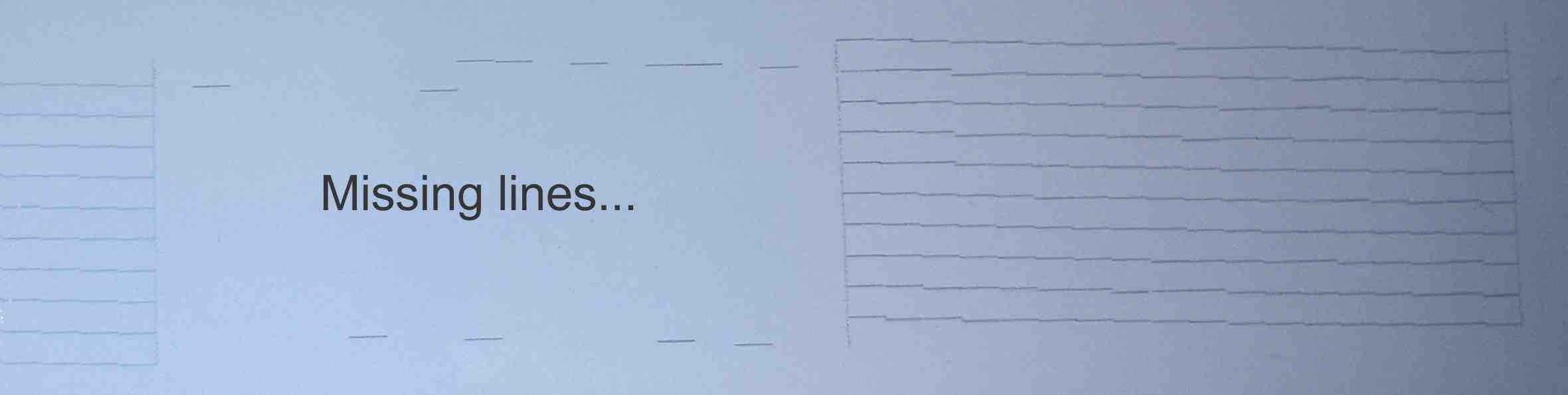

But the problematic black side of the black ink is a mess now. See attached picture.

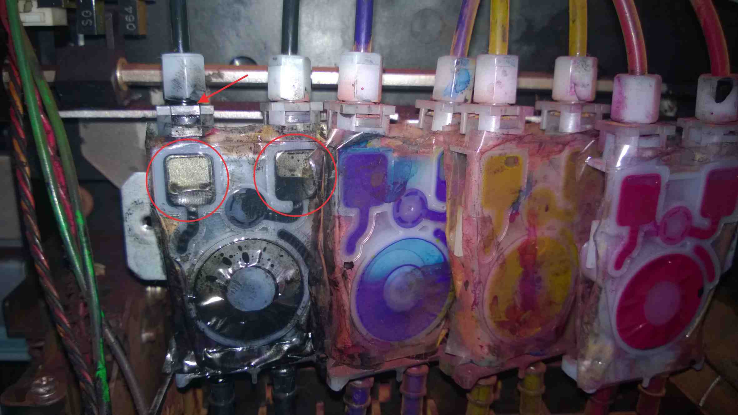

It obviously seems that some air is getting inside the damper. Now I visually checked the rubber gaskets and all of them looked well without any cracks or stretching. Beside my black hands, what I can see and looks strange is the air in the rectangular upper sides of the damper (in red circles). And there, where the arrow is pointing, the hexagonal side of the plastic part keeping tight the tube on the dumper, is broken. I mean I can rotate it without moving the rectangular part which looks to make the fixing. Theoretically I think this should not bother the tightness. I think it just helps to keep the plastic part in order to easily rotate it. Am I wrong thinking like this?
It happens I do not have a spare dumper to replace it but do you have an idea to (at least) temporarily solve the problem until I will have a new one? At least to explore something...
Any idea to be tested will be well appreciated. Even the theoretical reason for such a behavior...
