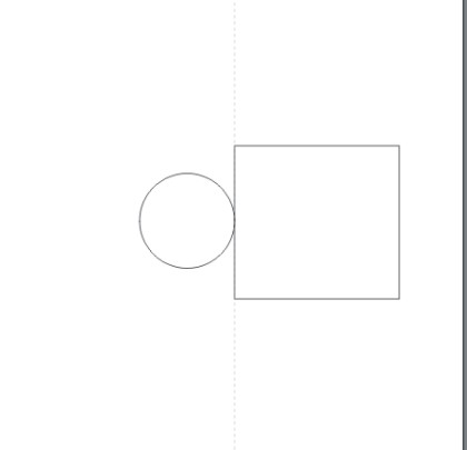

Like this..I need a fast way to do this. I spend alot of time nudging the objects I want to the outside. Thanks
Greg

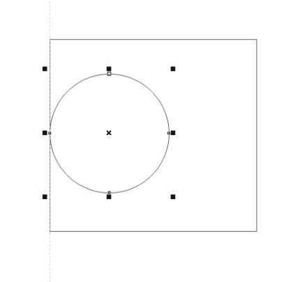

Another way to do it would be to:
select VIEW>SNAP TO GUIDELINES
Click and Drag on the ruler to create a Guideline
Click on each object and move it to the Guideline
Each object will "snap" to the guideline and will abut each other
I found no "automatic" way to do it.
