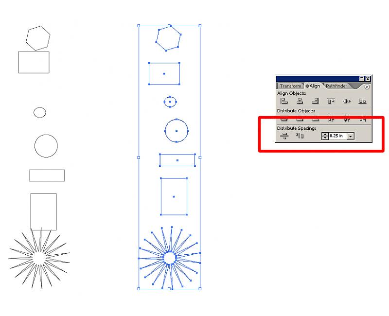

You need to use the distribute function if you already have the objects in place.
You can set the gap spacing from the distribute pallete. Select all your objects, then click once on one of them to set the master. Set your gap distance, and click the appropriate distribute button.
