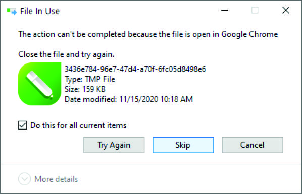

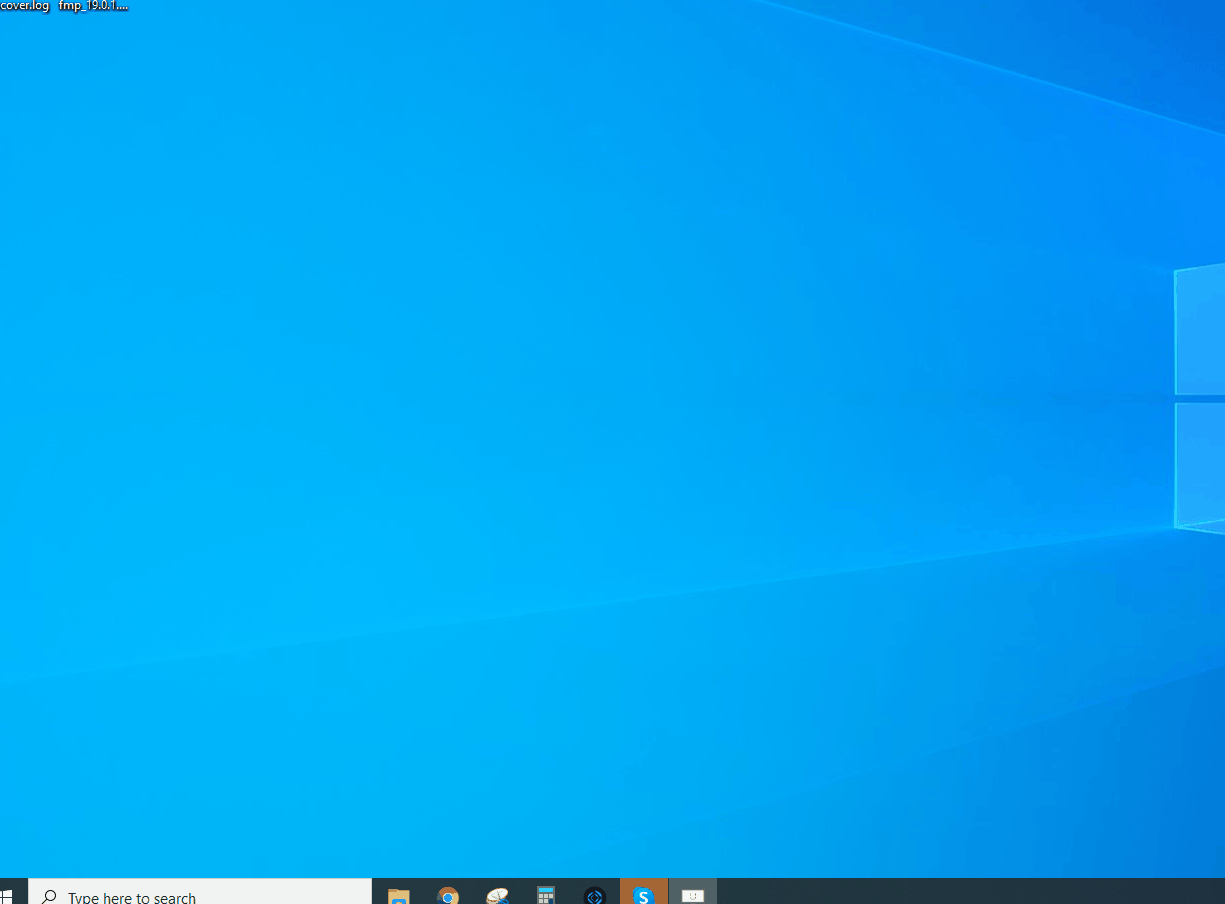

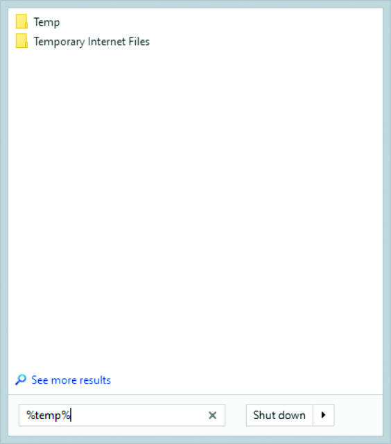

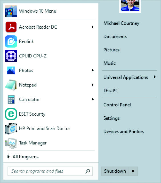

Also, when you have repeatable errors in a program, it's good to close it down, delete all the temp files, and restart the program. Your program will continue to see a corrupt temp file unless you delete it.
Close your program. In the Search programs and files type %temp% and delete all the temp files it will let you. If the program is open it will be in use and won't let you delete it. You should be doing this weekly after you start your computer anyway. If not you will see hundreds of megs of files left behind. Any files in use, check the do for all box and skip them. had 380megs, been awhile.
View attachment 150229 View attachment 150230 View attachment 150231 I checked mine and
I appreciate the suggestion. I have done as stated above. Its not my issue. From what Flexi support is saying is it has nothing to do with my PC. It is a 1 yr old gaming PC with maxed out RAM , but it is still limited to the fact that the software is still 32 bit and can only access a limited amount of memory. As soon as I throw an image with a bunch of nodes at it, it crashes or at ;least takes 10-15 minutes to even add cut lines. Guys on the support line have told me that they do not know if or when there ever will be a 64 bit version which stinks.
