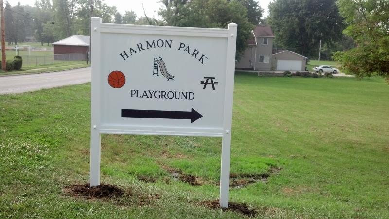

I always used the washer heads too, but recently found a company named dane mccall they make really nice pvc sign frames. I ordered two they routed a track for my alumalite to fit right in. Customer was very pleased!!! Real classy look, price wasn't bad, and went together super quick with all hardware hidden. Definitely a great alternative if your looking to secure it nicely with nothing showing. They will make the frame to fit special sizes also. Below is one of the frames I purchased.
