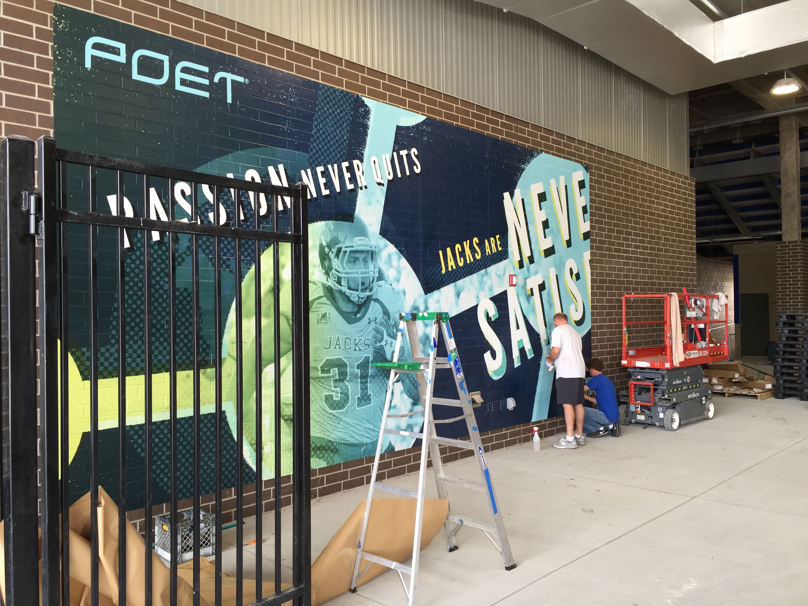

We are about to install our 2nd large (14'H x 50'W) block wall mural at the local university football stadium utilizing the Alumigraphics product. Last year I was AMAZED at how well this film prints / installs / looks! However...pushing the film into EVERY SINGLE mortar line was both tedious, difficult and somewhat painful on the fingers.
We found that using the rubber coated handle end of a rubber roller tool fit the mortar lines perfectly...but after a few hours of running mortar lines the rubber would eventually wear off and then the aluminum handle would begin to scratch the film.
Long story short...we're trying to find a a new trick / tool for running mortar lines before we embark on this project again. Anyone encountered this and found a good solution!? TIA
