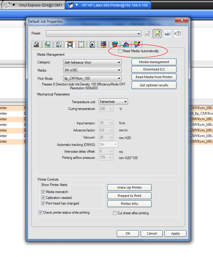

I MAY HAVE FOUND THE SOLUTION. In Default Job Properties there is a new tick box....I haven't tried yet, but this sounds like it would stop the nonsense. It was checked, so I unchecked it. We'll see how it goes.
