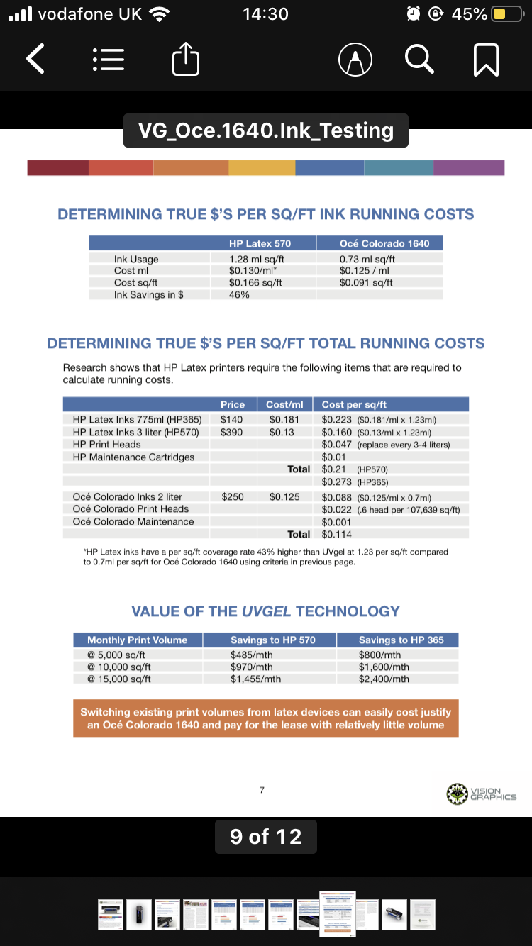

    43BC3953-AFDC-47A8-9336-3988144B0EA9.png We have a colourwave also that we use for indoor stuff or specific jobs that require to be kept in order. We have a click charge on that so having the Colorado and being able to run low ink consumption jobs on that does make life easier.
    as far as the uni costs etc go, I seen this online. Not sure how accurate it is. Probably doesn’t factor in a few other costs.

    Those figures aren't right at all. 3L 570 inks are $375 or $0.125/ml, our average calibrated ml/sqft at 8 pass is .89ml.
    Our total per sqft cost at 8pass is $0.25, This figure includes ink, heads, cleaning kits, maintenance adjusted lifespan machine cost, electricity, and labor... do those same figures on the Oce' colorado and it is almost 50% higher... Ink is such a small factor in the actual running costs. Our figures are based on a historical track record of 4 generations of Latex, 11 years of operation, and current consumption numbers by our machines. I adjust factors quarterly and our number barely fluctuates.

    Very true, the cost of the some of the maintenance equipment on the Colorado is laughable. Even the nitril gloves are 7x dearer from canon than the exact same gloves from a different supplier.
    I’m not massively keen on canons business tactics with regards to the wide format printers either. It’s all about getting a machine in your shop as cheap as possible then shaft you on all the *hidden* costs.
    they’re also failing to mention that you can get 3 latex printers for the price of a Colorado..
