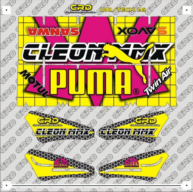

  15. CRD
    CRD Member
    333
    Apr 18, 2011
    Like said, I put underneath the markers white squares of around 2 x 2 cm.
    Gene is this what you mean?
    My SummaCut D60R-2E build in 2010 reads through the lamination.
    It is called OPOS-X what is used there.
    Paco
