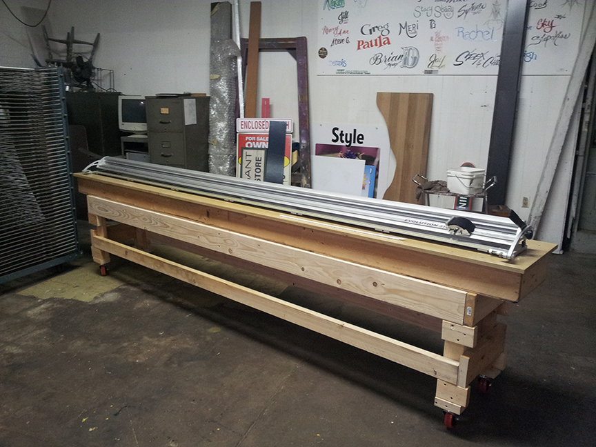

    If all you're doing is cutting straight lines, invest in a long Keen Cutter. Ours is 126" long and we use it for vinyl, PVC, styrene, gator, shocard and so many other substrates. It cuts up to 6mm PVC in 2 maybe three passes. Vinyl is a breeze. Best part is, ya only need one person to handle it.
    I just recently built this table and put the cutter on top with locking wheels. The materials cost about$90 and I had about 3 hours in cutting and assembling it and it's 100% dead balls level.

    I've been meaning to grab one of the Big Blue or Sooper Edge rulers for a while now. Have also been eyeballing that Keen Cut as well. We have rulers in 4ft, 6ft, and 8ft lengths. I ordered some thin cork roll material and attached to the underside to help prevent scratches and hold it in place better. I use these for whatever length I need with either a No. 11 Xacto or a snap off NT/ Olfa kinife. I use some Quik Clamps if I need to be perfect or have an especially long edge. Empire and Starrett are the rulers we have. I would recommend one with an anodized or non-painted finish, as you will most certainly cut into it at times and un-straighten your straight edge.
