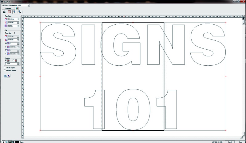

I wanted to know if there was a way to print a copy of how tiles are set up when we cut vinyl. I know I can print the entire layout, but sometimes I'd like to give the guys a guide to where the tiles are.

I don't see an option to do that in the vinyl side of Flexi 8.6.
You could full screen the panel tab of the cut/plot window and then do a print screen to the clipboard and print that.
