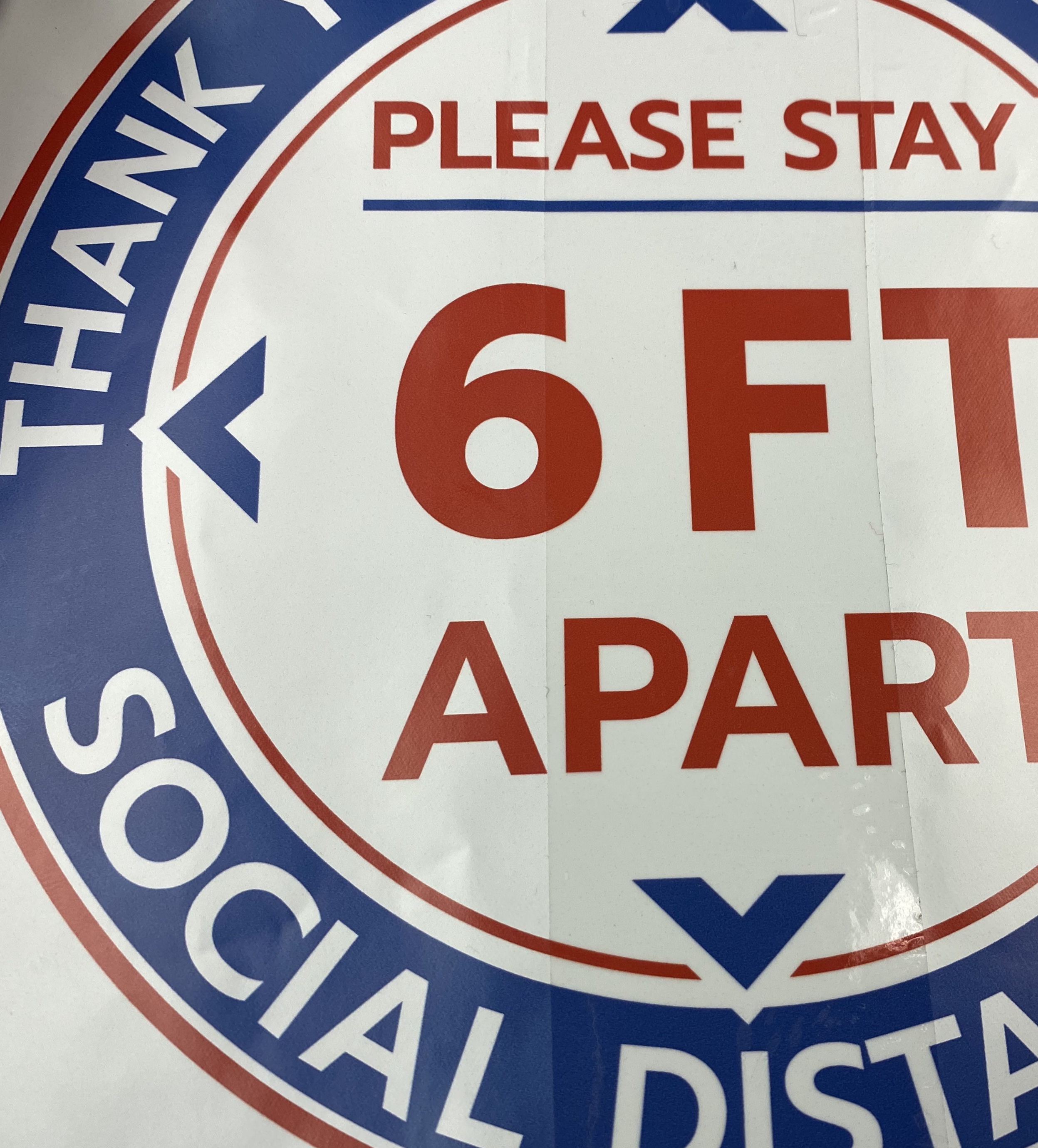

    Had three rolls of IJ 40 C delivered started printing and color and overall print quality really bad!
    Loaded 35c and printed same file and profile with excellent results

    We use quite a bit of 40C. Haven't seen anything like that yet. Have any pics of the printed area flat on a table? Maybe another area or 2 of the same roll/sheet.

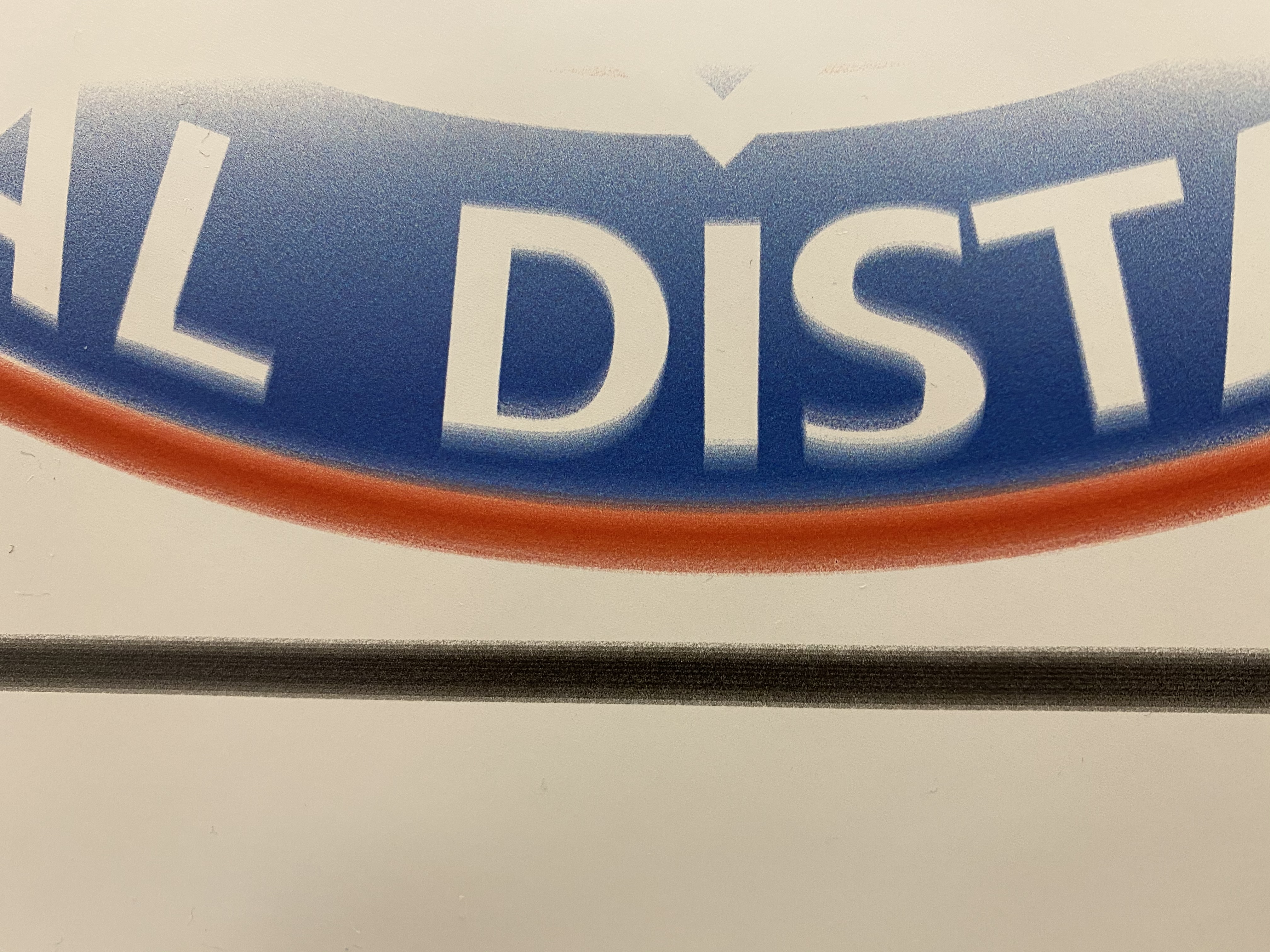

    Try cleaning off an area with Isopropyl to see if it's old vinyl with plasticizer migration.
    I would also clean off the encoder strip, because that was my first thought before you told me that other media works fine. Are you using different presets on the different materials?

    That area right there looks like its a mechanical issue...misalignment somewhere along the print.

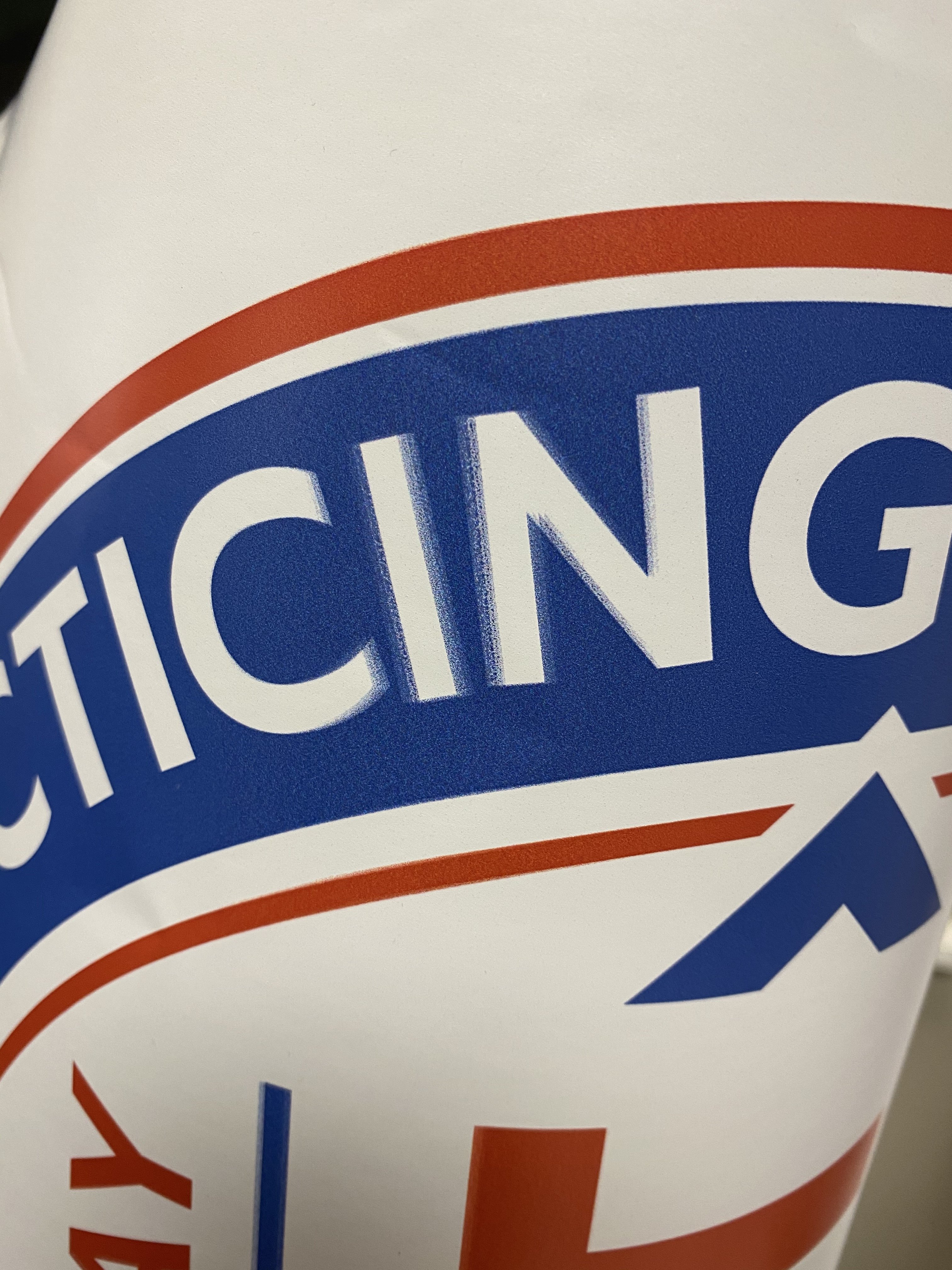

    Printed on hp570 here is another shot! Did An alignment ,checked all status plots only happens on IJ 40
    running 180 and all is good

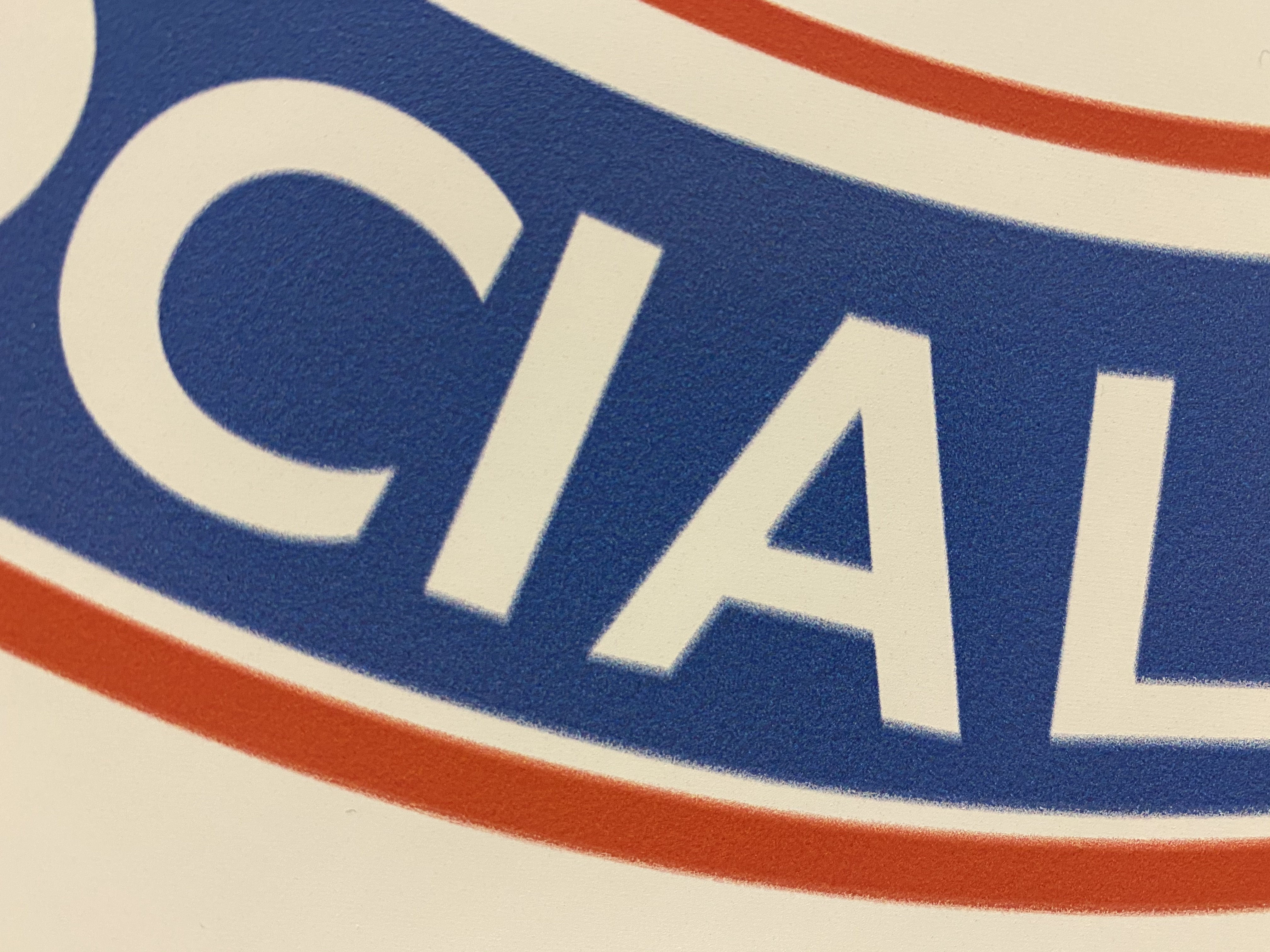

    Pic on 35c

    upload_2020-8-13_15-21-5.jpeg 35c
