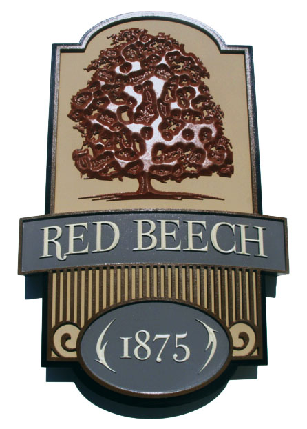

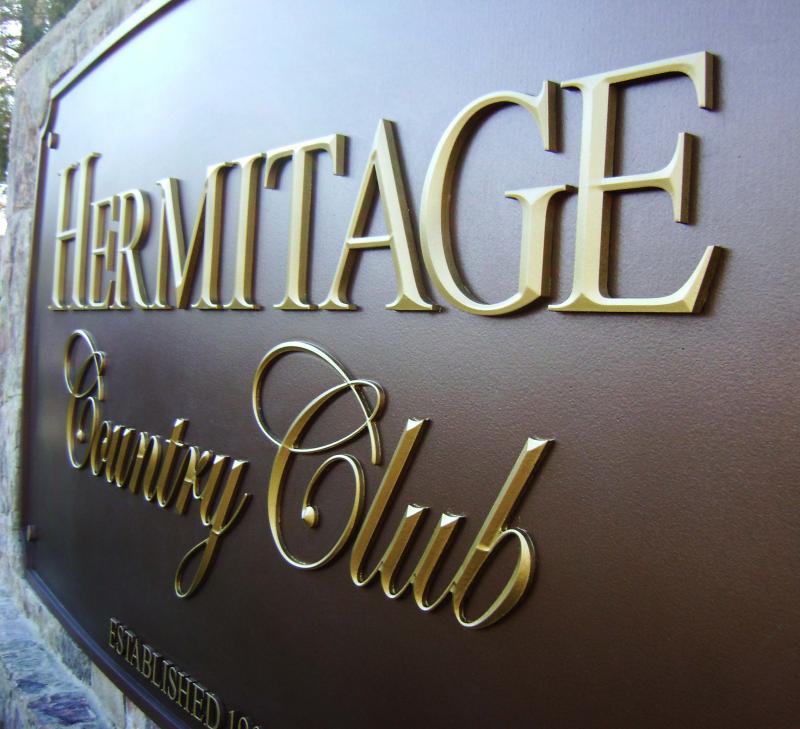

    We get Designboard from N.Glantz and Son(http://www.nglantz.com/) and use the 18lb density. That is what I would recommend using, because I feel there is a big difference in quality from the 15 to the 18.
    We use to use Sign Foam III in the 18lb from Harbor, but the price was just too much. I feel that the Designboard is a pretty equal competitor. We don't really hand-carve anything all of our dimensional work is done using a CNC.
    Here are some pictures of some signs where we have used Designboard.
