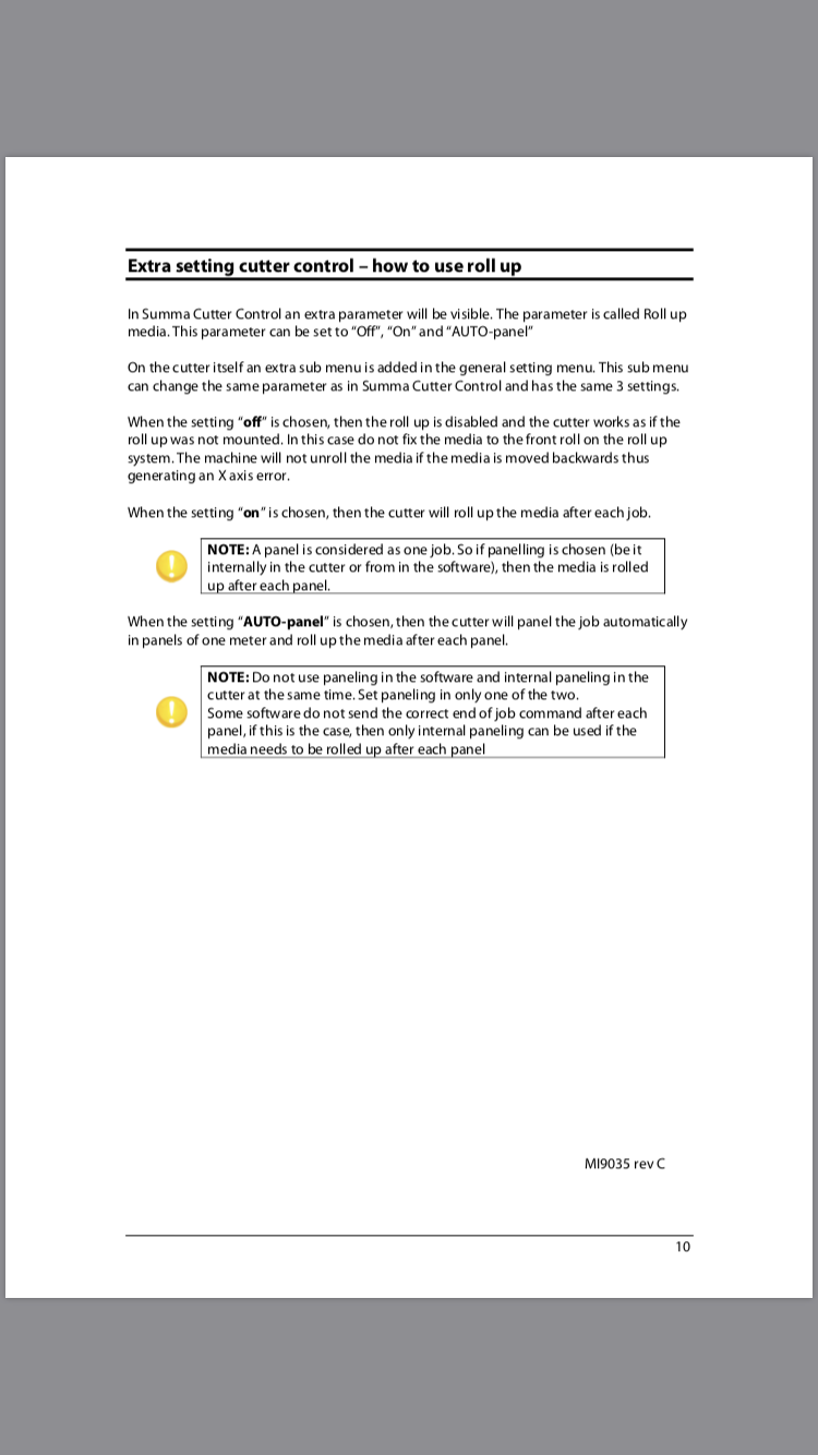

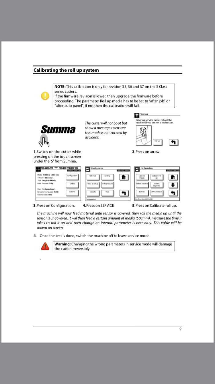

    I've added the Roll Up (take up system) to my 64" Summa TS2-140.
    I cannot find info anywhere with instructions on how to operate it.
    Anyone know how to...or can point me to a resource that you know discusses it?
    Thanks.

    97ABD798-83C9-4BE0-B78C-AFDD7A4B7788.png E9ED7535-7BDB-493C-8A4E-9A7CF70FDC25.png

  3. iPrintStuff
    iPrintStuff Prints stuff
    1,039
    285
    83
    Sep 3, 2018
    United Kingdom
    We’re looking at adding one. Hope those pics help. Got them in a just in case folder lol

    We have it. It only rolls up after the current job is finished cutting. Not sure if paneling causes it to roll up mid-job but my recollection is that it waits for the job to finish. You have to properly route the media to the take-up or it won’t work. I attach a 4’ leader to the take-up core to make it easy. There is an optical or sonic sensor that figures out when to stop rolling up. If the sensor does not detect material it won’t roll up. Easy to use, and a life saver on long jobs. The trick is to break up the job into smaller jobs so the machine will roll-up every few feet.

    We also had no idea how to activate it. There's a sensor hidden at the back so if turned on in the front panel it will simply start taking up.
