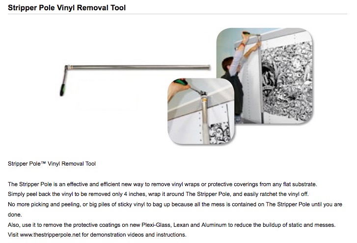

Anyone know where to get the stripper pole?
TheSnowman
Have a HUGE need for the stripper pole vinyl remover with a client that I picked up, and I'm losing my mind just rolling a tube with my arms crawling all over the sign trying to remove 4X8 prints.
Anyone know anyone that would still have these in stock? It appears as though they're out of business cause their website is defunct now too.
I'd like to have it here for Monday delivery if I can find someone with one.

Well, I actually gave a fabrication friend a call today, and I'm going to swing in and get a new ratchet and socket that's big and drop it to him tonight, and I should have one made tomorrow. I know it's probably not hard to do if you have a few machine tools. Should be a cheap way to go and still get my projects done. Haven't ever had to remove full 4X8 sheets on a daily basis until about two weeks ago. I knew there was a tool that used to be made for this.

We use a 60 inch broom stick. Cheap and you can throw it away when done.

Sorry for my ignorance, but even after read the text in the fist picture I'm not quite sure how it work.

We have a job about once a year to strip and recover around 35 2'x10' prints on ACM, we ended up using some 1" black pipe we had lying around from when our sprinkler system was serviced, cut a piece long enough to cover the vinyl, add a 90° piece and you're in business, you really don't need the rachet., The best part was we just threw out the vinyl covered pipe when we were done.

Seriously, are they really claiming a trademark on the name Stripper Pole?
I'm sure many of dollar$ will be thrown at that.
