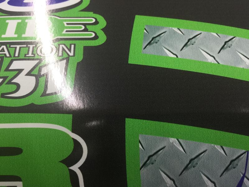

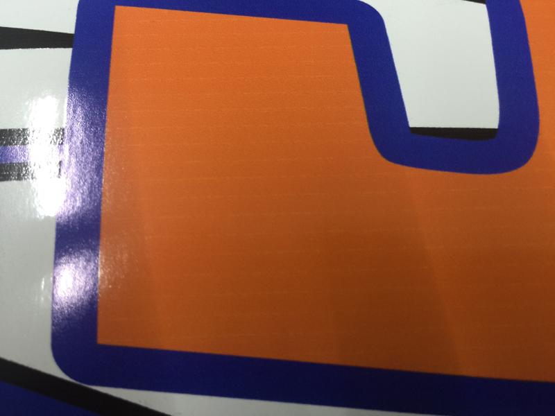

Banding and tiger strips in the colors if a rasterized vector and grainy looking if it's a vector. Even when printing oracal 3165g profile and q4 high speed 720x1440.
I attached the best 2 images I have at the moment of the green one showing the grainy and orange shows the banding. Green is a vector at 150dpi. The orange is a vector that has been rasterized in illustrator with 300dpi.

Banding: PF feed isn't correct or you have clogged nozzles.
Grainy: Flexi settings, sometimes. What are you running in terms of print quality?

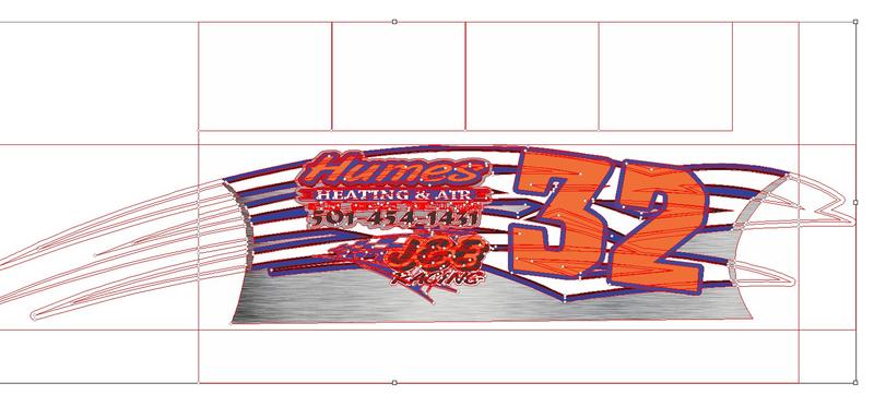

No clogged nozzles, the banding is gone now that i have saved the file as EPS and not AI. But now when i have a clipping mask or shadows in teh design and i save it as an EPS and i bring it into flexi i get this. Its a bunch of small boxes that i have to delete. I am guessing it is the clipping mask or something. File was rasterized at 300dpi then saved as an eps. Now opened in flexi and i get these.
This causes all kinds of problems when i need to make a contour cut around the object and also be able to size accurately b/c of the areas i have to delete. No i can delete them but the are is still larger than the print design.
I can get rid of all the extra stuff but it is an act of congress to be able to contour cut but it can be done with some work with deleting all the boxes that show up. If not masks are done then it is not an issue.
Unless someone can show me how to create a design with mask and shadows in illustrator and then be able to save it as a 300dpi raster in case it is for a wrap then open it in flexi and not have all the boxes.
You cannot save it as an eps without it being rasterized b/c it created white boxes where any of the shadows are.

Why are you rasterizing your files? You should be able to save as an EPS and just import directly into Flexi. Rasterizing vector files just lowers the quality and makes the file harder to process due to it's size. I am thinking that the boxes are from Flexi interpreting the rasterized files from AI differently.

The reason for the rastering is b/c apparently when clipping masks and shadows together and you try and open the file in flexi it gives white boxes with all the shadows and these white boxes cannot be deleted without deleting the shadow. I have tried it more than once to just save the file as an eps and open in flexi but have yet to have any luck with it.

The boxes you get around your effects, like shadows and outer glow etc, are due to the rendering intents in your RIP not agreeing. So most RIPs default to processing vector and bitmap images differently which means when you combine the two, you get conflicts. If you set the rendering intents to match for vector and bitmap in your RIP, it will fix the issue. Also, the same thing can occur if you are mixing RGB and CMYK images into one file and using transparencies.
