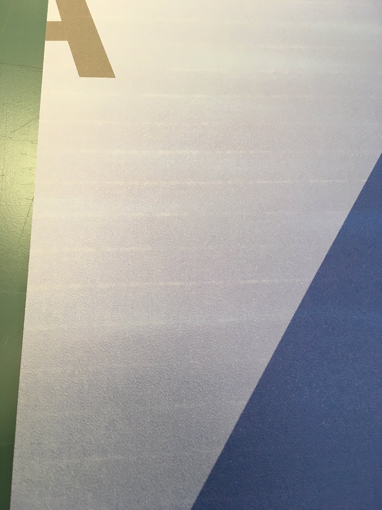

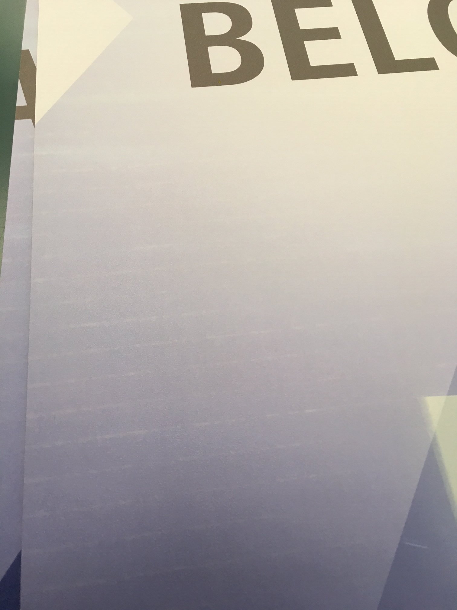

    We have been using DreamScape brand Wall Paper. Specifically, Caviar texture. When medium to lighter ink usage is printed , there are white lines that run horizontally with the roll ( approx 3/4" apart) These lines appear to be like a "resist" of the ink on those areas. We have an Arizona 1260 flatbed. We print in production & quality modes using 7-and higher pico liters. Still seeing the lines. We do massive wall paper murals for high profile, industrial client environments, where continuity is essential. Our work around is to throw down a white plate to "prime" and hide the lines, but then we fight color shift issues from one mural to the next. Just wondering if ANYONE out there is having this problem.
