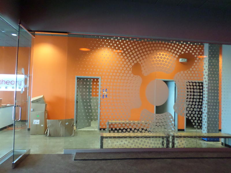

We have used the Mactac before with great results. We had to do multiple large windows in dot patterns that just would never work right in regular 3M frosted. (windows in picture are around 9'x4')
