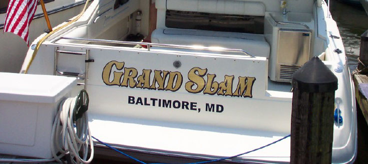

I used it on my Dad's boat, WOW, beautiful stuff. I layed it over a Oracal Mooonlight Blue (dark blue) which matched the canvas top. It cut and weeded well I thought. Very $$$$ BUT my Dad wanted it to last. The gold used for the previous name faded after 4 years.
Here's a pic. The font was not my choice. I had to re-create what was already there.
