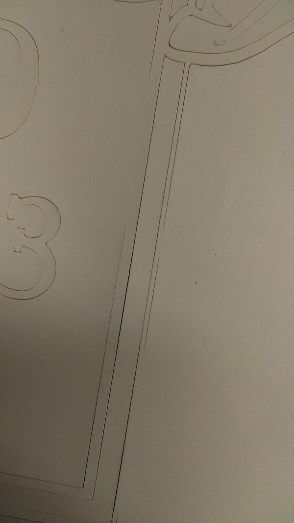

I work with an APD Extreme Series (FB-18361?) flat bed plotter at my monument shop. We use it to cut stencil. I'm running into a problem where the lines that the plotter is cutting are slightly off sometimes. I've uploaded an image of the problem.
The two lines on the left and the two lines on the right are supposed to be the same, but one (on the right) is obviously significantly thinner than the other. It's like the stencil is getting moved, but it's not. The plotter is also having trouble returning to its "home" position after cutting.
I disassembled and cleaned everything, but that didn't seem to help. I also noticed a small fray in one of the belts, which might be the issue. In the meantime, I shaved off the fray with a razor blade, but that didn't seem to help much either. It was suggested to me that this might actually be a software issue, but I'd like to rule out any hardware issues first, since I know that I can probably fix that myself.
