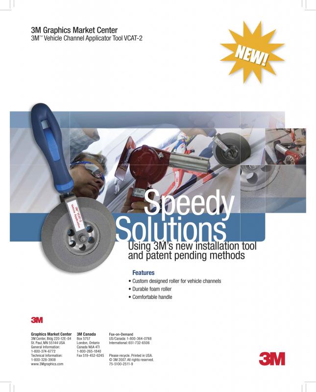

    You mean like a rollepro???
  5. wedosigns
    wedosigns Member
    253
    Sep 8, 2011
    Here it is.
