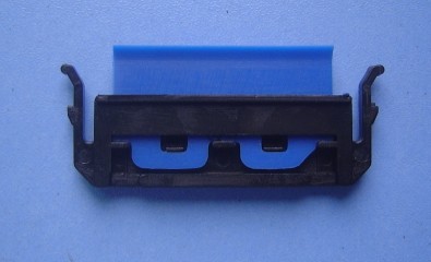

    of course they are different.
    please check the pictures in attachment.
    JV33 wiper width is double JV3 wiper width.
    Adam from Inkmed
