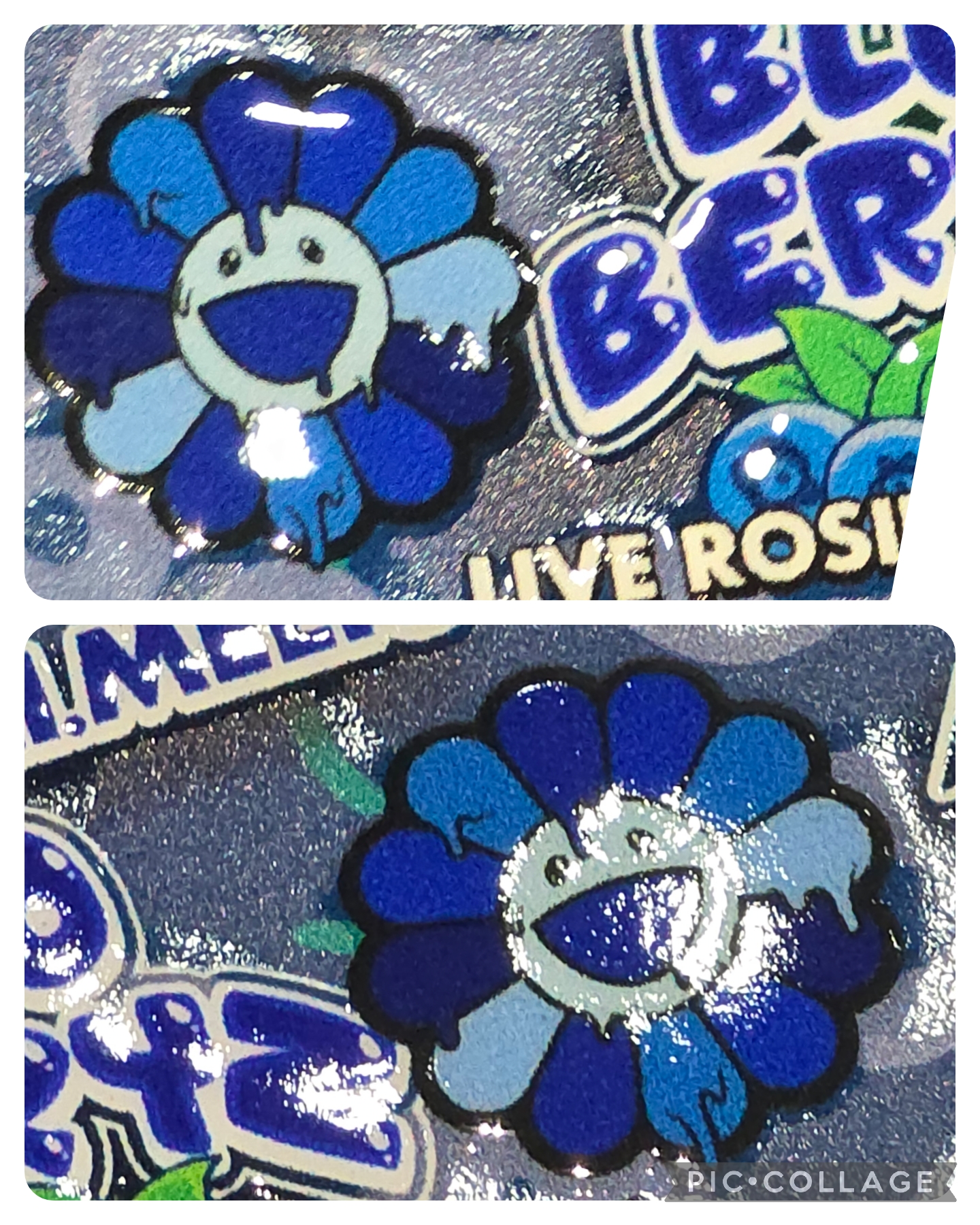

Question Are there any inksets or settings for the UCJV300 gloss that makes it more comparable to Roland gloss prints?
Smoke_Jaguar
Print a nozzle check? Clear ink can do weird things and get a bit foamy and fire weirdly. I think you can also try gloss at 1200x1200 DPI (that might not work, since I am using modded firmware, not sure if it is supported on regular firmware). Also, what firmware are you using?
RonnyCrack
UCJV300-160
V3.2.0 firmware, and I've been mostly doing these tests with 1200x1200 to get better coverage, the 600x1200 tests end up with the same effect but an obviously thinner ink layer, so it's a bit more noticeably textured. 1200x1200 (especially with 2 overprints) starts off pristine and degrades after an inch or two. Nozzle checks are coming back like 99% fine. Truly just feels like it drops less ink after that first inch or two. Here's a better image of the difference - beginning of the print on top, end of the print on bottom:
Smoke_Jaguar
Is your vacuum force set to high? If things start off good, the media might not be lying flat. On the quality page about 2/3 down is the setting to change vacuum.
RonnyCrack
UCJV300-160
Yes always set to strong in the printer setup - I'm trying one with it manually set to strong in the quality settings though, in case something isn't translating properly from setup.
Smoke_Jaguar
Can also try tensioning the roll using the take-up roller to make it lie nice and flat. Either media is moving, or nozzles are missing if I were to guess.
RonnyCrack
UCJV300-160
Just tried one adding a good amount of tension and no luck either unfortunately. I don't think it's tension or necessarily nozzle related (unless the nozzle is starting to have issues mid print) because no matter how many times I try, it's always pristine at the beginning and degrades by the end. Whether I print one after another, wait between prints, change tension, change UV percentage, etc. the front end of the print is always perfect and degrades after a couple inches. It's just weird. Maybe an issue with head voltage dropping mid-print? I've heard that can cause degradation in the middle of prints.
Smoke_Jaguar
Head voltage is best left alone. Have a service manual to help check calibration? Might be a stagger issue.
RonnyCrack
UCJV300-160
Section 4.2 will go through the calibration process/adjustments.
Oh, shoot, I did all the dot position corrections when I set my head height to high because I was getting a lot of ghosting. So unfortunately not sure calibration is the issue either. Maybe the head slant. I'll run the tests and see if they need any further corrections. I'll report back if I end up with any solution. If not, I'll just hope my clients won't be as nitpicky as I am, lol.
