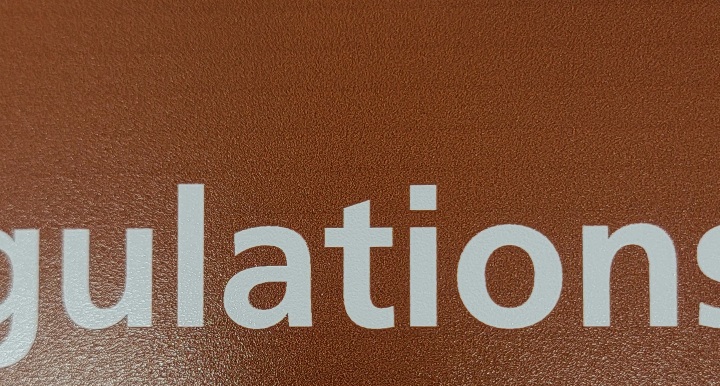

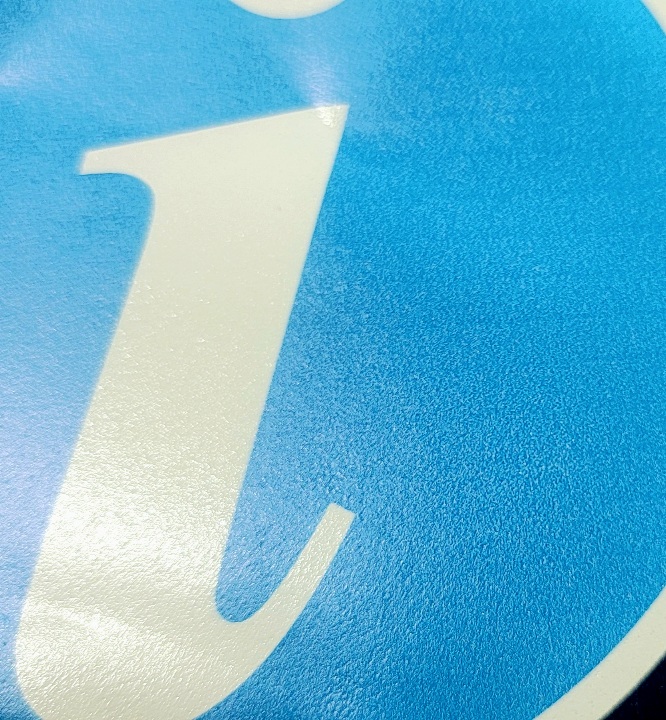

Good morning all,
I have been having issues with the Spot1 white layers and have tried adjusting the opacity which, hasn't done anything.
I am getting (banding) a tech has come in to adjust the heads and of course, I forgot to bring this problem up to him.
Does anyone have a clue on how to fix this?
When using it in Bi-directional.
When I tried Uni-directional it wasn't as bad. That setting takes way too long for prints though when doing (spot1-spot1-CMYK)
Thanks for any help!
Caren

I'm assuming you are using Onyx? The problem might be your white ink level. You can select 1-6 I think as your levels. When I run my 460GT at level 6 I see banding in white, when run on level 5 it is smooth. I think if you right click on your job, select edit printer setting then select your ink layers there is a custom option and you can select spot 1 and the level it prints.

What media and print mode? Looks like it is in the color layer. Can you print the ship print in the same mode and get clean prints with no banding?

Quality mode. It can be on any media It comes up on all. I don't print on Vinyl with the flatbed.
I run a print head cleaning before I do any jobs. Plus every morning.
Inks are still (Full) It's not in the colors. You can only see it in certain ones.

It's usually because the white is only calibrated to some extent, and not the same as CMYK.
print a circle and a square. 50mm x 50mm or near.
put a white Spot1 to print under it.
either use a vector or do it in illustrator.
See if the white bleeds.
ONYXtechtips
Have you experienced any print carriage collisions or has this been an on going issue? I have seen banding caused by misaligned lamps in the past. You can also try to set the lead lamp higher than the trailing lamp and see if that produces any better results. Also ensure that the lamp lens is clean. Finger prints on the lens can cause banding
