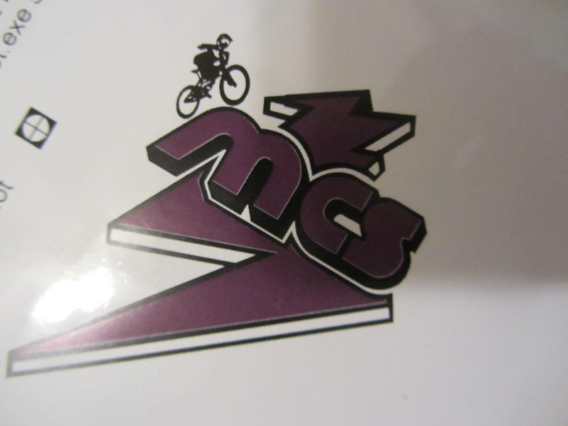

Ok, I tried another print run, And I got it right on the top part of the lighting bolt.
But Not the rest
Do I have too select multiple designs to get them all to overprint?
