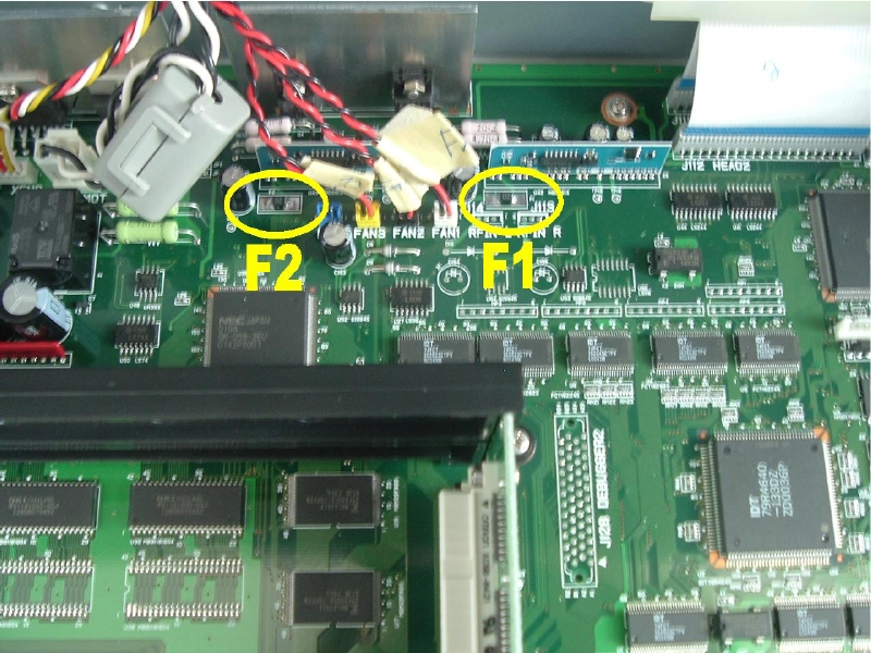

They have a help section that shows where the PICO Fuse goes on the mother board one of those two fuses is cooked. Trust me!:Welcome:

Generally when a fuse is blown on this model the printhead likely needs replacing at the same time. Could have a head cable that is arced to that left printhead which has been known to happen. As stated on previous threads the manual draw of ink through the cap when the carriage is forced over to the right and manually drawing ink with a syringe on that left cap. you get ink into your syringe and then no firing of that head for a nozzle check* you have a blown fuse or printhead or both!

Fuse?
I need help. I have a 48" mutoh falcon outdoor printer, and today in midprint it just shut off. Now it won't turn back on. I've checked all the plugs and called mutoh service and they said it may be a 6.3 slow blow fuse. They say its located by the power supply in the circuit panal box. I open the pan and I do not see the fuse. Is it incased in something? Please help. Thanks BIGFOOT
Headhunterx
