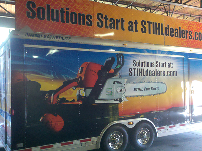

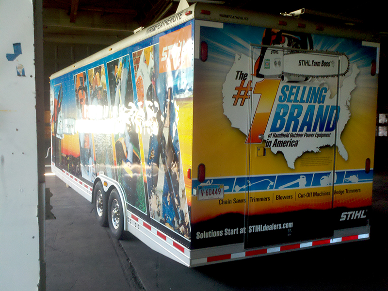

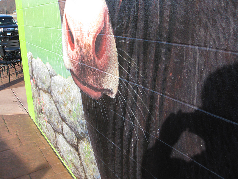

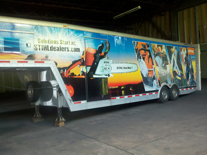

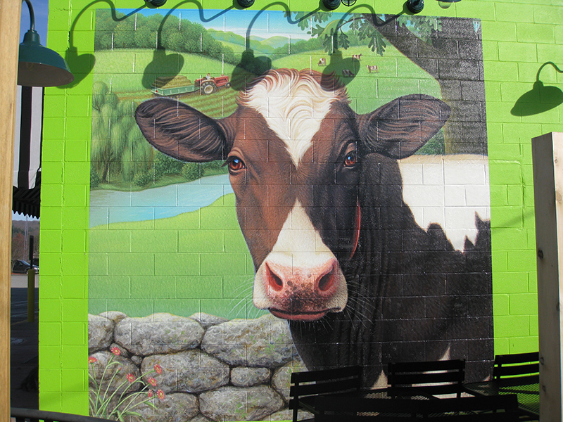

Envision Combo is a great product. It is a premium product and should be priced, sold and advertised that way. The non PVC is a great sell to the right market.
3M was kind enough to sponsor us with a few rolls to test, give feedback and a couple case studies.
The cinder wall was printed on HP LX 850 latex and installed on a 50 degree day.
The trailer was printed HP XL 1500 solvent.
Very impressed.
