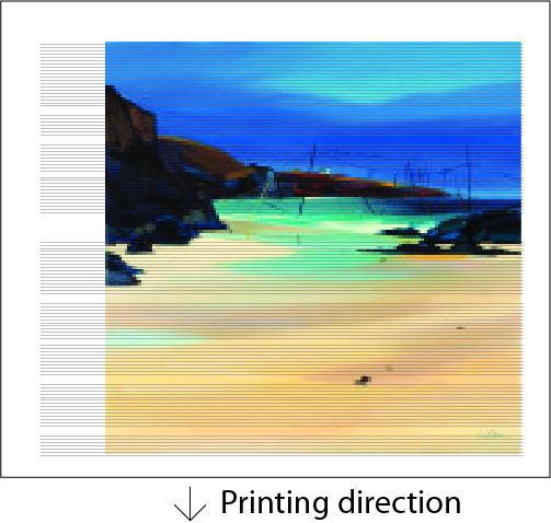

I may have the wrong termanology then, as the banding isn't darker or lighter shades of colour in the print. Its more like the thickness of a pen line running full width of the media, or as far as the print head is moving to. With out posting up pics at them moment I'm trying to describe it the best I can. so I've mocked up an image to give you an idea of what I'm talking about.
Cheers Mark

bob
I hope someone can help, and I know banding is something that theres loads of possibilities it can be, but I've tried everything.
I have 2 mutoh rockhoppers and one of them has started banding black lines across the media.
At first I thought that it was a bit of fluff that had dragged across because some of the lines are wavy. But I've done a power clean, even taken the heads out and cleaned all around them.
I thought it was an issue with the software or the network cable as well.
So after trying everything I took out the heads, capping station and pump and put them into the other machine and its got exactly the same problem.
Its only the black that is doing it. So I printed a test page from the printer rather than the software and there's no banding from the black.
So does this mean that its either a network problem or software problem and not the heads?
Cheers Mark
You have a weak head. Change it.
