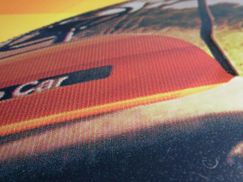

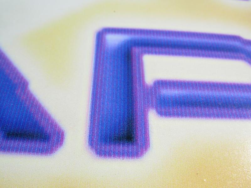

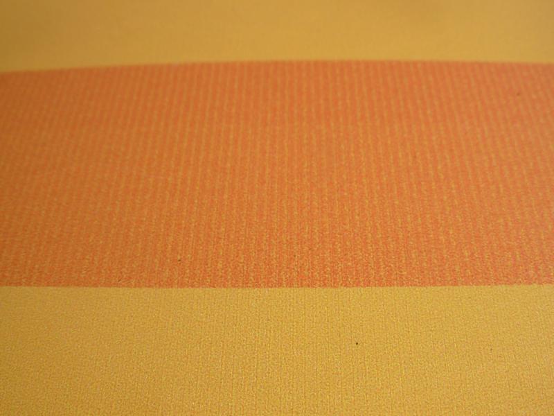

Well, I’m getting serious Banding on my Falcon Out Door 48” (Extra by Sign Warehouse)
Awhile ago I changed some step feed settings but couldn’t tell you what all I changed.
To start with, it seems prudent to reset all settings to the factory defaults and if necessary, move forward from there.
So, is there a menu selection to reset to the factory defaults?
Thanks for any help….
Brad.

I think the most common banding issues are a problem with the heads or media feed step. I had a simular problem and it was a combination of both but make sure you play around with the media feed some more.

NO is the answer to the question and as for the banding, seems you youself created it... Perform the Page Feed adjustments and you will resolve your issue...
Brad.
No is the answer to your question. As for as the banding based on the information you have provided seems you created your own problem. Do the Page Feed Adjustments and your problems will be solved, that is providing that the Check Nozzle Pattern is correct...
