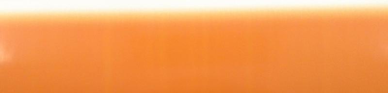

So what causes this banding? I'm using the Arlon 3mil 720x720 G2 profile in Flexi Production Manager. I switched to the Arlon 720x720 G4 profile and it went away but the dots are not as fine. Is it the Arlon material or the profile? I'm confused on this. I've had different material give banding at the end of a roll but this is a almost new roll.
Thanks!
Bryce
Any time I've had that issue it was because the heat setting (usually the preheat) was too high in the profile.
Those are roller marks and it's caused from the media being too warm & soft when feeding through the printer.
I always turn the preheat down first then the platen down if needed. Start with 5 degree increments and see if that helps.
brycesteiner
Thanks! That never crossed my mind. I will turn the heat down. I know I've turned the heat up for banners to help them dry and that worked too.
