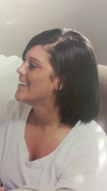

Magenta bending problem on Roland XC 540
Hi guys,
So, our Roland XC540 printer has been having banding problems with the magenta. Attached is one of the prints that we recently printed and if you look closely you can see the magenta banding on top of the girls head. We swapped the dampers, did calibration, changed the captop with no luck.
Any other suggestions that is not already in this thread of what else we can try would greatly be appreciated.
Thanks
