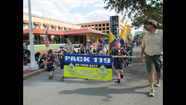

Thanks for everyone's help on this, the tape was definitely enough and these boys were proud to walk with their banner!
