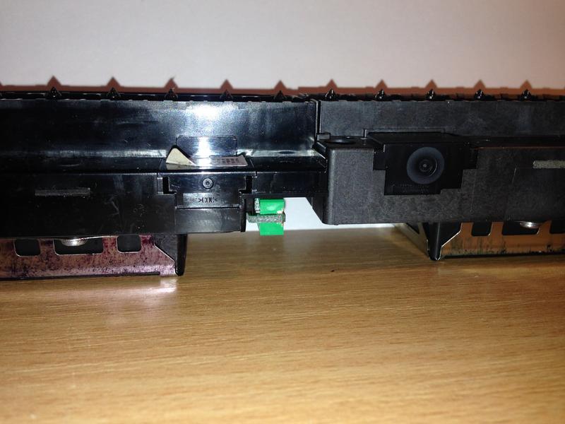

Epson F186000 printhead have a little bigger front side of manifold.
For install this printhead in Mutoh printher you have to cut a little head fixer frame.
And Head Rank have another format, so you can't write it in printer's HeadRank menu.

I found photo with OEM Mutoh printhead (with green connector) and F186000 together.
You can see a difference in level of manifold front side...
