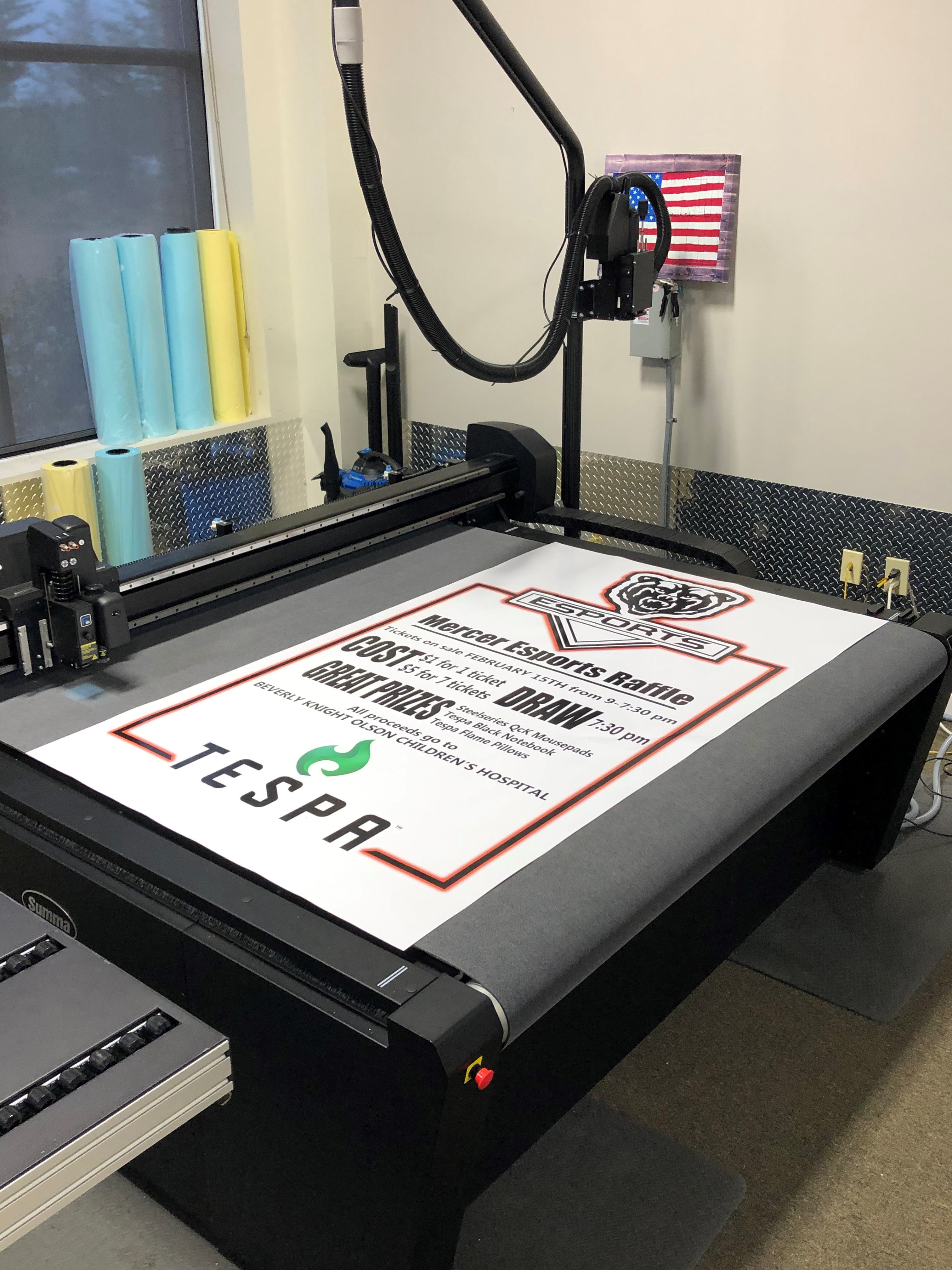

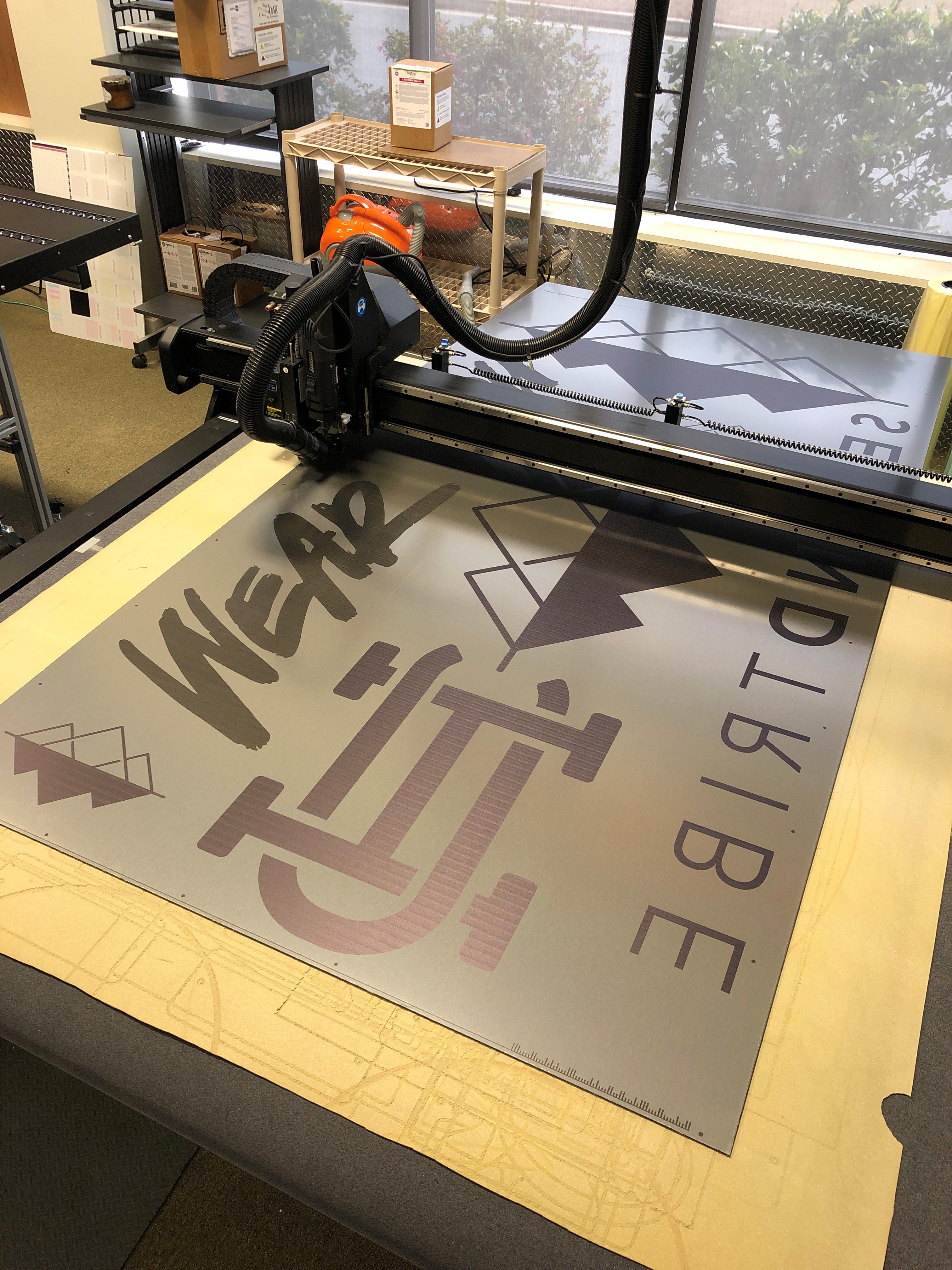

Don't know what your budget is but a machine that pays for itself starting day 1 is a Summa F1612 table. Workhouse of a machine I use mine every day for cutting a multitude of different media, mainly coroplast. Just send the cut file, import, hit the button and you're done. My favorite machine in the shop.
