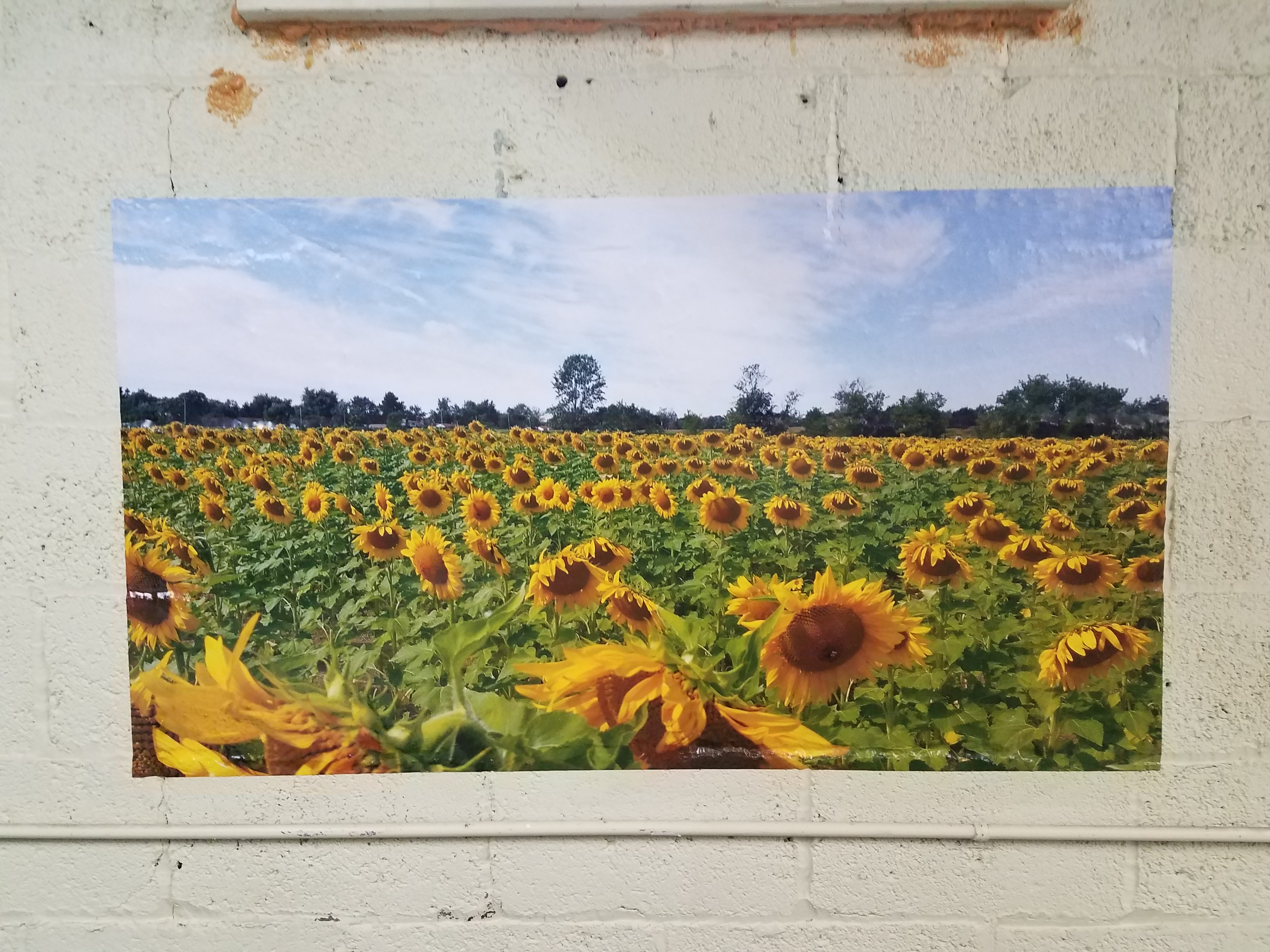

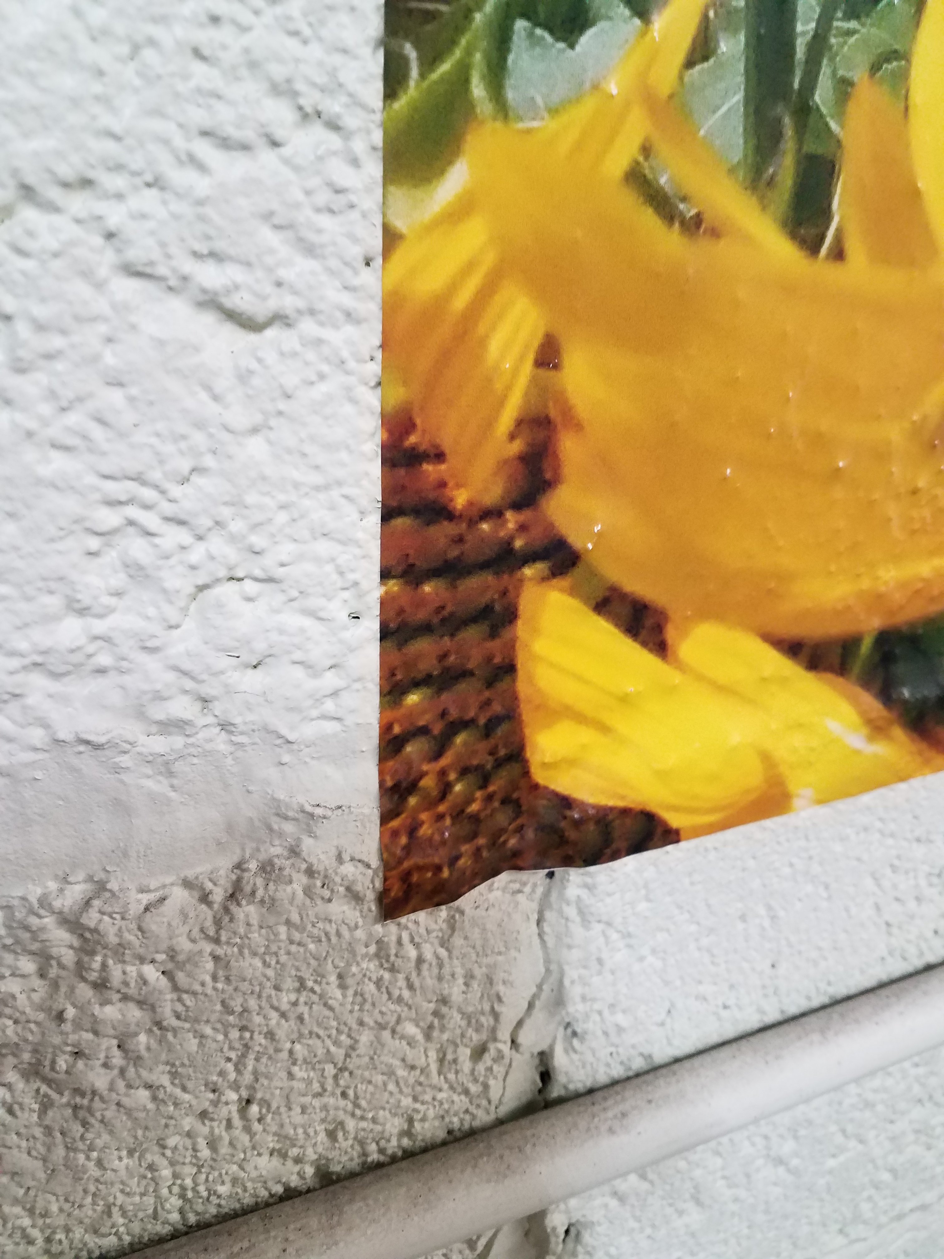

granted this is on painted block wall, I put this on my shop wall a couple years ago to see how well the material would stick (DPF8000) and it hasn't lifted anywhere.

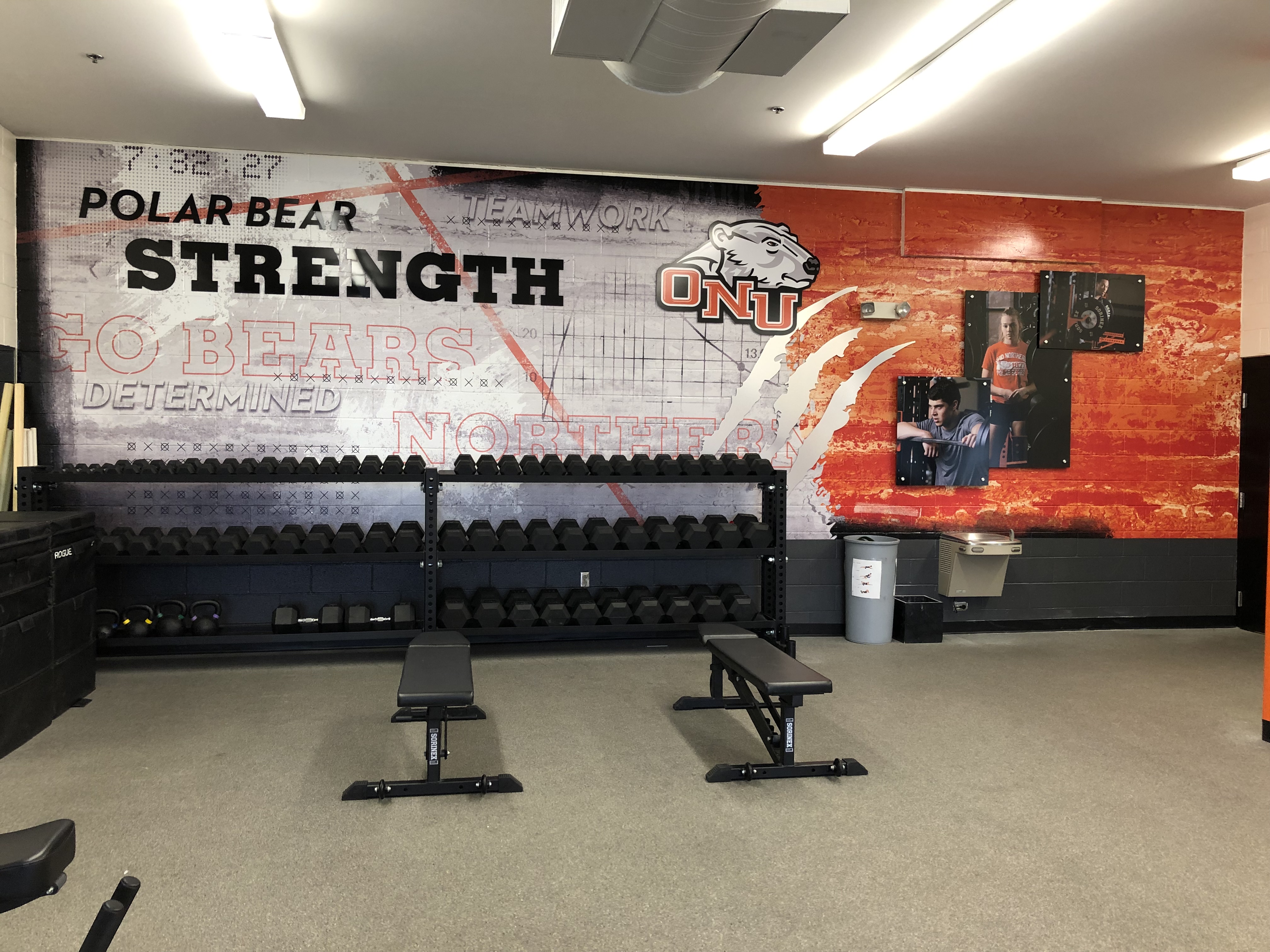

I will agree with Coloradosigns on the 3m IJ480. It's great stuff and installs even easier with the right tools. Here is a wall that we did about six months ago at a local college
