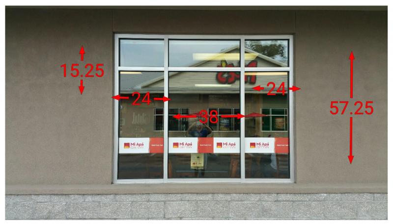

I bring my iPad with a stylus pen. Take a nice flat picture. Open it up in "Draw on Top" app and record measurements. This way I can easily add it to the customers folder when I get back to the shop. Heres a pic for example. IMG_0284.jpg

I bring my iPad with a stylus pen. Take a nice flat picture. Open it up in "Draw on Top" app and record measurements. This way I can easily add it to the customers folder when I get back to the shop. Heres a pic for example. View attachment 117481
In your picture, I can't figure out why that bottom window is smaller then the first two ?? Am I missing something ??

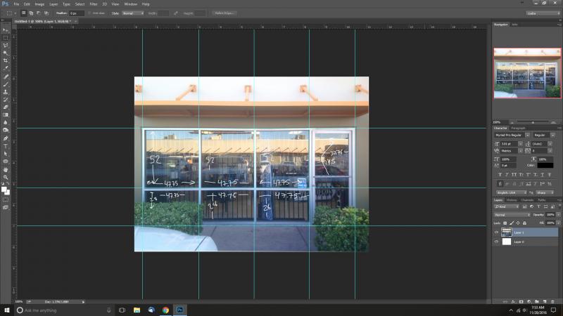

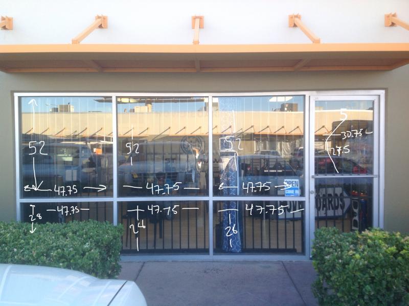

All I do is take a high-res picture ( unless if you take pictures with your calculator this won't be an issue)
Then measure overall length and height.Plus always measure the frame width also. And that't it.

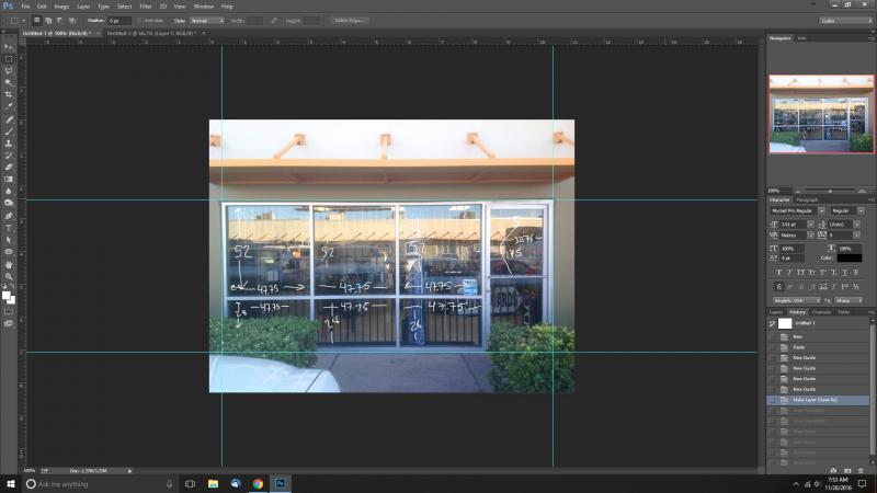

I will open the image on my computer and make the window frames all squared out in photoshop ( see attached pictures)
Scale up your two measurements and boom. You got everything measured. I have done a LOOOT of store fronts this way. Never had a problem. Unless you got to much obsticle blocking the store front and can't see it on the picture or the store front is suuuuuper big this should be fine. You will need 1/4 maybe 1/2 inch bleed all around. If you like to cut the window perf to be exactly the size of the window because you don't like to cut then you might have to measure everything one by one.
This never failed me tho. Super fast. 3 measurements. 1 picture.
Hard to see it on the first pic but the window frames were not parallel with the guide lines.
