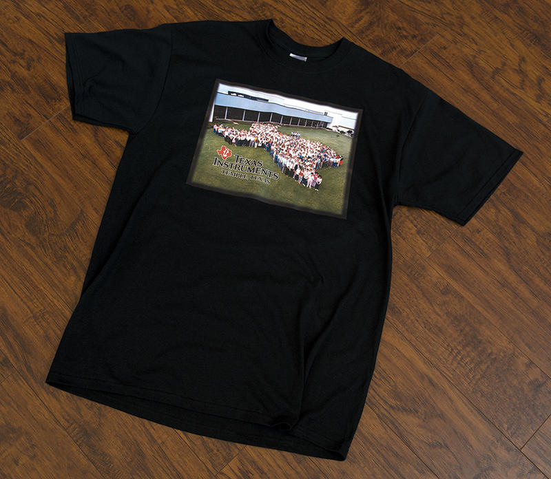

I have only used Eco-Print from Imprintables Warehouse, prints good and no drying time, however it does feel a little thick and heavy on the shirt.
I would like something with a softer hand as they call it, I will be following this post to see what others like.
