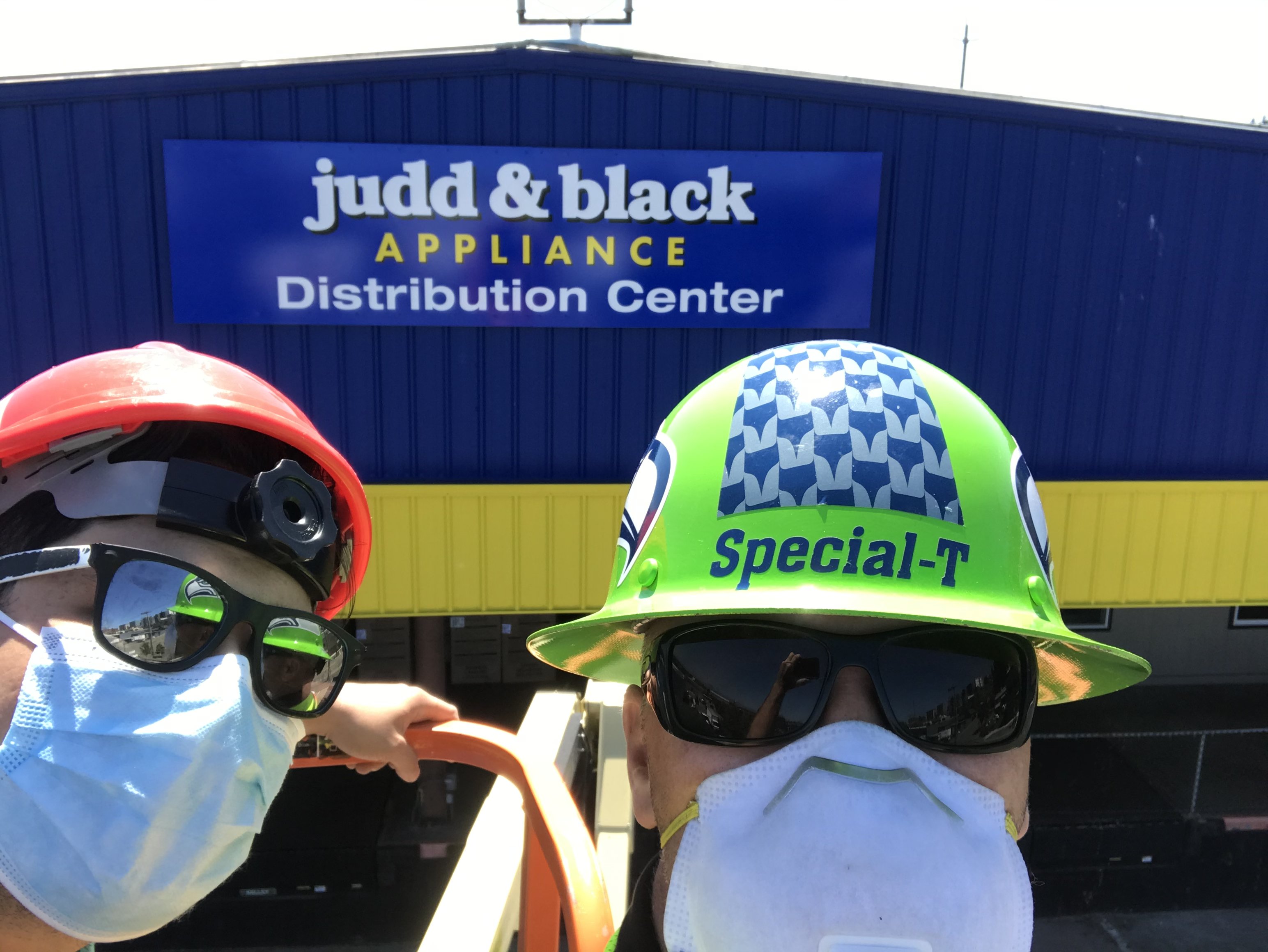

I like ACM (Dibond) with a French cleat. Once the cleat is installed you just lift and set the panels. secure the panels once in place.
