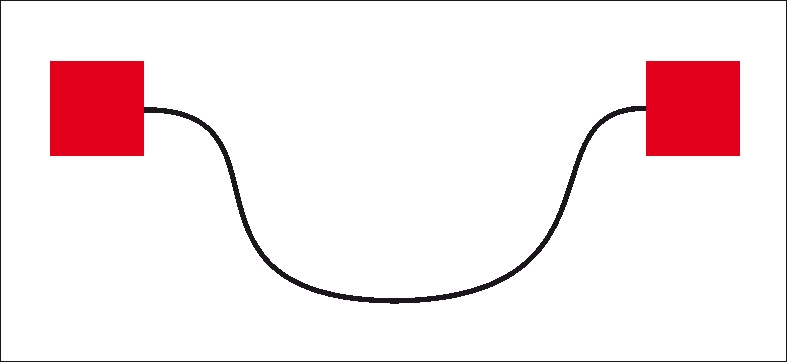

what wind slits did you do?
we are doing one like these... maybe you sholud add some extra material at the end of the cuts (same thing as on edges)... so, you would prevent tearing these wind slits...

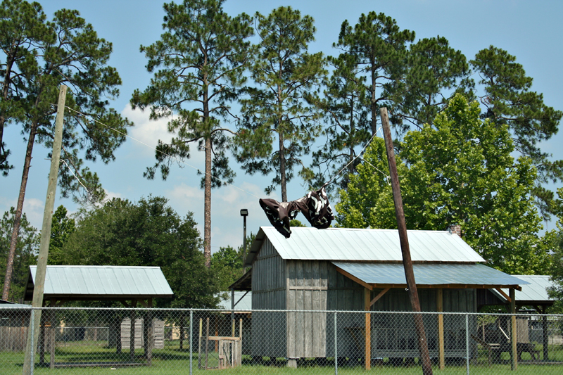

Stop Sign: I was worried that a mesh banner wouldn't be strong enough to handle being stretched for the install. This banner is literally installed between two telephone poles.
Insignia: The last banner was installed with ratchet straps.
SeaWriter: I think that's where the last banner went wrong, it was only 13oz. The one that lasted 4 years was 19oz (I believe)
There is a steel cable that runs between the two poles but it's not very tight. They tried installing the banner using zip ties to the steel cable. That obviously didn't keep the banner taught and it just clumped together in the middle (See photo). After that we went back with ratchet straps.

you need to install a new cable, or two new cables. Not that hard, if necessary mount a boat winch on one end to get it german tight.
Mosh
That is the problem right there. The banner hung too loose and the flapping is what destroyed it. The two tight cable system is the only way you are going to get a long life for the banner. Seen this same thing happen 100 times, good banner, poor installation.

Looks like you will have to drop 'guide wires' down into the ground as well to support those poles. All something the fair grounds people should be capable of.
heyskull
Banners are a temporary sign so I think for 4 years this has way outlasted its design life.
The poles are not adequate for this job as it looks like the tension of the banner and the wind is pulling them over.
I like the idea of msenjur with his strengthening of the wind slits and tension it properly so it is tight.

I was told the poles were reset this summer and are now plumb and stable.
I think I'm going to go with a 19oz banner and two steel cables that run between the two poles (One for the top of the banner and one for the bottom) Maybe even add a few ratchet straps in the corners to ensure it's stretched enough.

Sometimes it is necessary to not plum the poles. Add a certain degree and then pull to plum with tension. We did this with flag monopole billboards and added 10 degrees to offset the weight.
