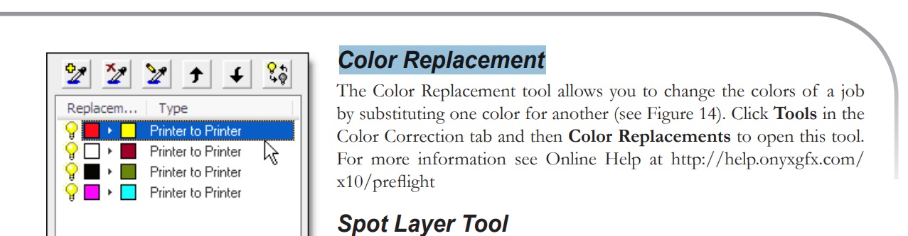

It's been about a million years since I've use poster shop, but isn't there a color replacement tab? I would always select the "black" in the file and replace it with 20/20/20/100
Jay Grooms
Printing, Printing, Printing......
did a bit of googling and found it!
