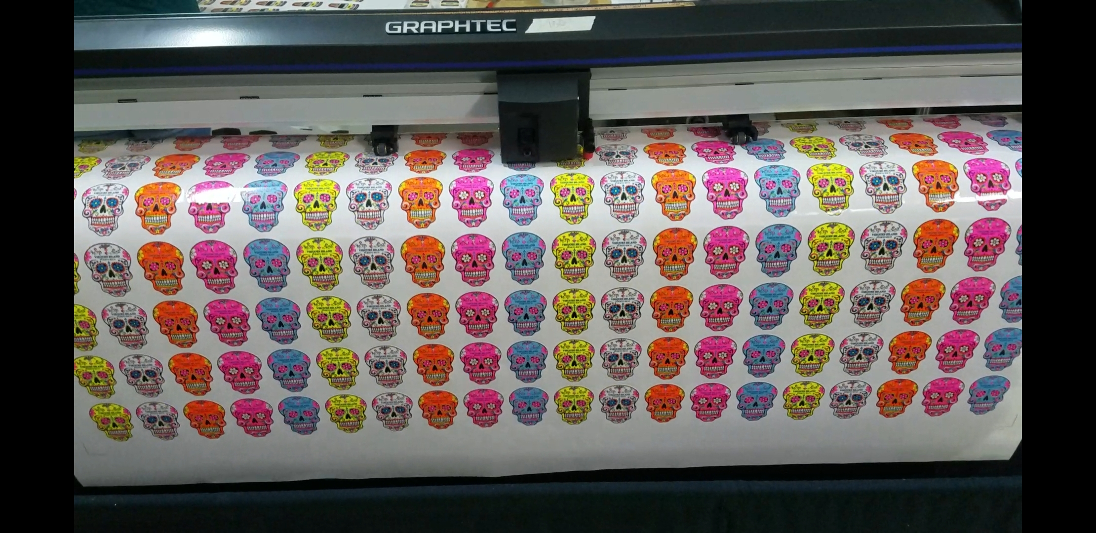

My graftec 8600 130
Cutting 30 sets of 5 colors grouped. Cut 5 sheets of these.
After cutting I alligned all 5 sheets and punched them out together, it took less than 5 minutes to punch 750 total stickers and to seperate the colors.
If I can figure how to post the video here I will.

My graftec 8600 130
