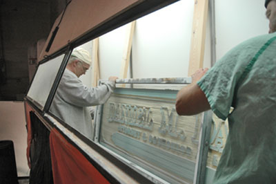

Building a blast cabinet is fun and easy. The one in the photo is 12' wide with re-movable plex viewing screens. I made this one with "Hoola Skirts" which allows me to put my arms in the cabinet for blasting. With the end removed we could walk into the booth. I had the complete booth welded up from 1.5" angle iron for $450. The removeable plex viewing screens allowed for quick removal of panels to be blasted.

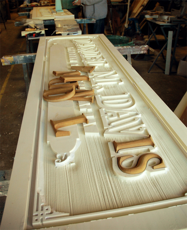

100cfm is a minimum air supply for larger work. You'll also need a good vacuum to clear the dust from the air. In this pix you'll see a grain frame but that was never as interesting as wood grain. I've made a half dozen grain frames with lots of different gauges wire. It takes a full day no matter what.
Please don't use sand for blasting. It's down right dangerous. A better choice is Slag or Glass Beads. They won't cause silicosis.
