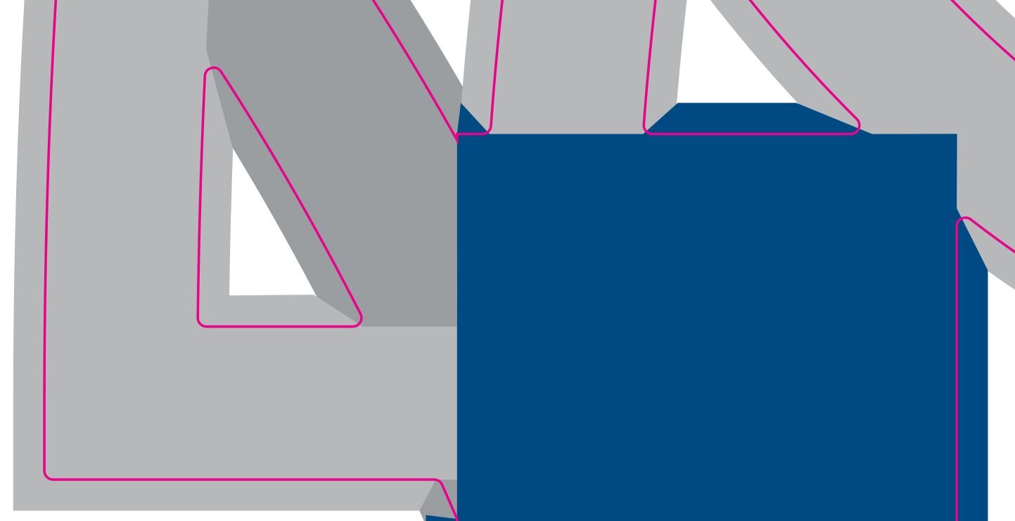

how do you make bleeding when there are multicolors in object? it there some function that would do this?
i got these files where bleed was ok, but i doubt that author did it manually...
i got this logo and i dont know to create such bleed....

In these cases I usually select all of the objects I want a bleed around, copy and then paste in front, meld them together and expand, then just use the path offset function to set the bleed where I want it.
ok, that is also how i do it...
but what about in corners? see corners in first attached picture...
