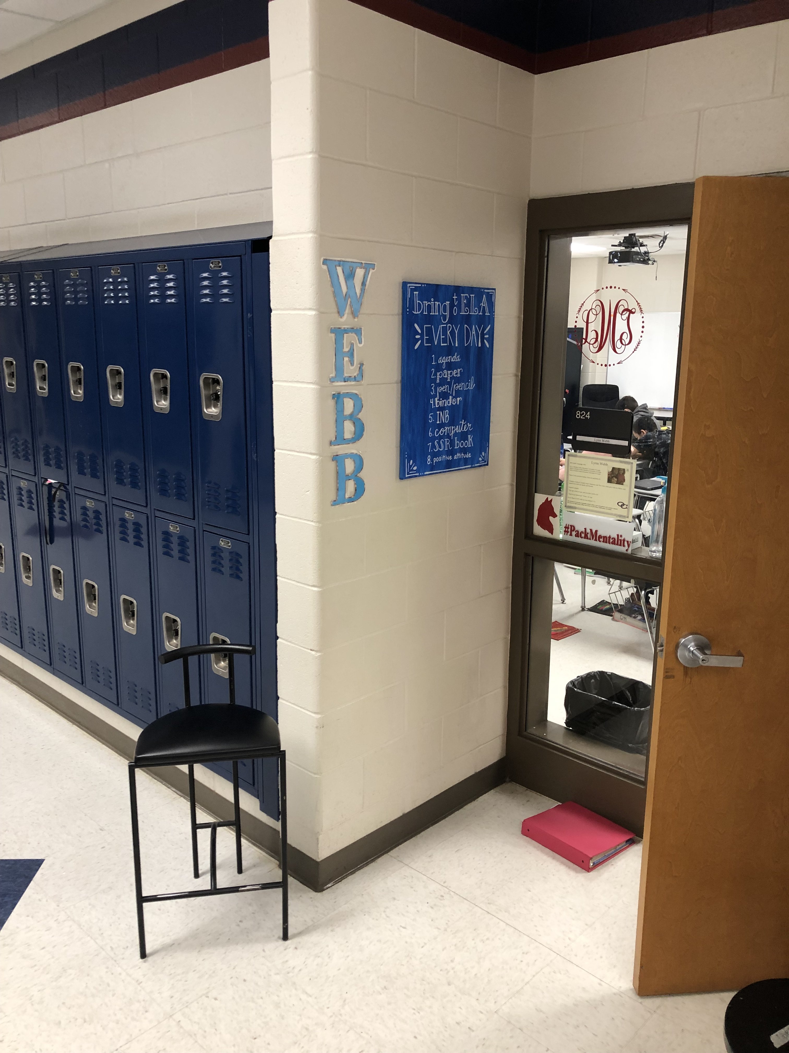

A local school is wanting me to wrap this small side wall and end to look like books for the teachers going into their classrooms, What material would you guys suggest for this?

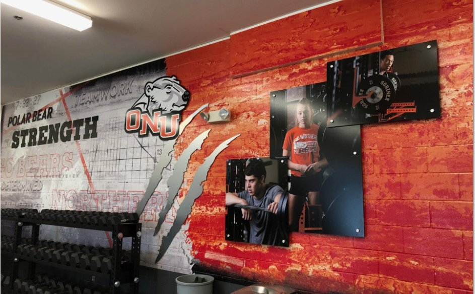

We just wrapped a block wall just like this at a local University. We used 3m's LX480mC and it turned out great!

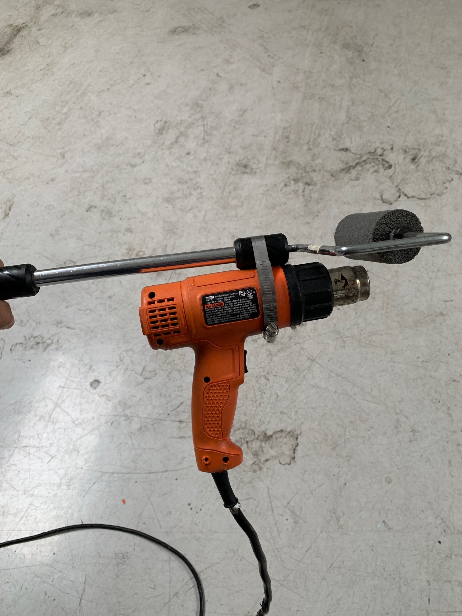

Or if you like to save yourself a lot money do we did and made our own tool. Get a roller replacement head, a paint roller handle, a clamp and a heat gun with an extended 50' cord all for less than $75 total and it works perfect.
