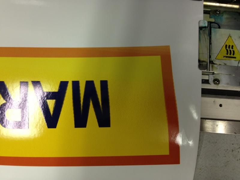

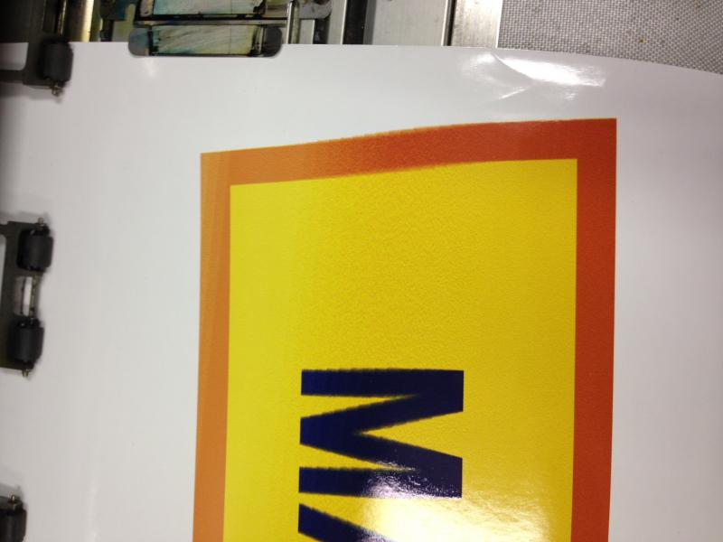

Hello ALL! Have a mimaki JV3160SP, printer has ran fine for years. Been having trouble lately with what I think is communication. Print starts to run, for example a solid dark orange, with blue text inside. As it gets a little further down the text becomes almost 'blurry' with rough edges on the sides of the letters, not crisp like a couple inches up in the same print. It also fades from a dark orange to lighter colored orange. I have change the firewire cord, as well as the firewire board in the computer. Sometimes I will get lucky and the print will go like its supposed to and maintain crispness and color the whole way through. Its more off than on at the time so I am scared to let any large vehicle wraps run. Please help! Mimaki tech says it may be the encoder or encoder reader or both, I can see such for the blurriness but what about the ink fading to a different color and the test print coming out just fine. Seems like a communication error to me?

just added pics! dampers have been changed fairly recently. along with a couple new heads. test prints are also flawless. no jets missing, i have never seen this before ever out of this printer.

It looks like your print is running diagonaly. Ive had that problem on a roland before. Replacing the encoder strip didnt work but replacing the encoder itself did work. The blurriness is because your printer isnt aligning its passes (similar to your bidirectional being off) because of the messed up encoder/encoder strip. No idea on the color shift.
